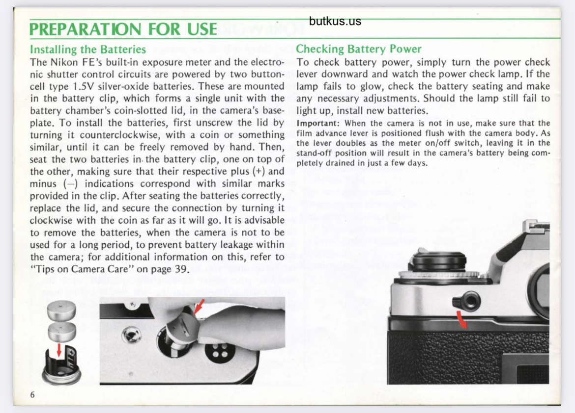

Ok, an update on my last post - after some more testing I’m quite happy that the shutter is accurate at all speeds, with batteries inserted. The meter also seems accurate, so I could shoot this camera fully manual today.
The problems boil down to two things:
1. The meter is *always* running, with batteries inserted. Is this a problem with the meter switch or is there a short somewhere - which is more common?
2. AUTO mode on the dial only fires at 1/90th (or thereabouts). The meter works and shows an appropriate speed, but the shutter behaves as if there’s no power and fires at default M90.
On that last point, an observation - I think there are two versions of the FE. The camera I have will happily fire at all speeds on the dial *without batteries*, but only at 1/90 regardless of the speed set (inserting batteries restores the marked speeds). Others here say the FE will lock up without batteries and only fire at the M90 or B setting. Which is right? I think both!
When I went looking for a manual for the FE I found two different versions on manualslib and Butkus respectively - take a look at the differences on this page:
