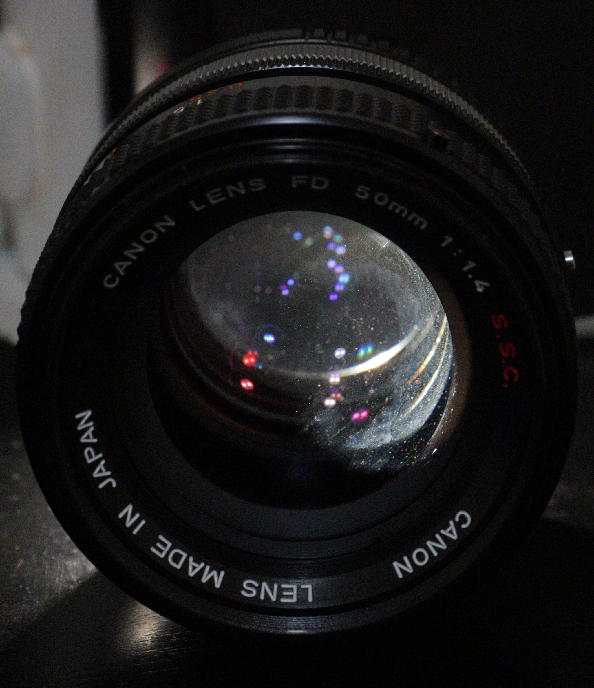

Here's the haze on one of the lens. It fully encapsulates the whole element inside the lens, only the middle is clear. Also the rear element has it too.

It is common with this model. You just need to hunt for one without haze. Personally i prefer the New FD version.
The other 50/1.4 lens that tends to suffer from haze is the Pentax-M and Pentax-A 50/1.4. Many, many lenses with haze.

I have to repair such old lenses about two items a week - and about 40% of them have only oily aperture blades, about 30% of them have only hazy lenses, and about 30% of them have both issues.
