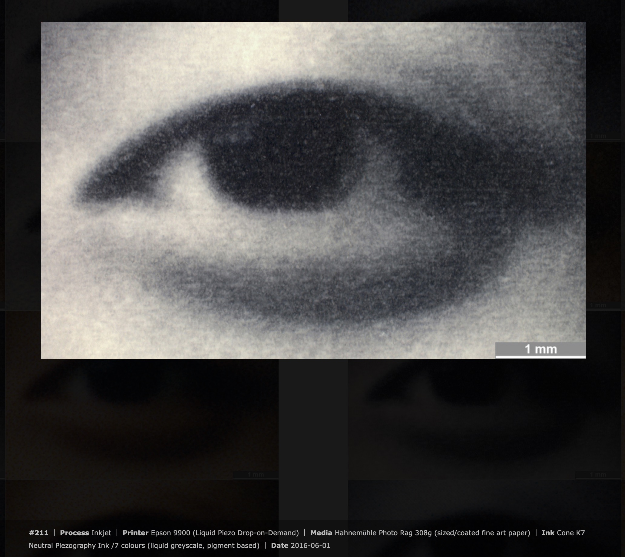

I'm sure I have posted this before, but if you are interested in pixel peeping prints have a look at Jurgens work.
Thanks for linking this; note that several of the color chromogenic digital prints show the phenomenon I mentioned. Some quite strongly, some more subtly. In some, the effect is entirely invisible or at least easily overlooked.
Note that in none of the prints I've seen/handled myself, it's a practical concern since the pixelation is never visible to the naked eye.
The Cone Piezography prints looks the best to me for black and white, at least there is a feeling like grain and no tint.
