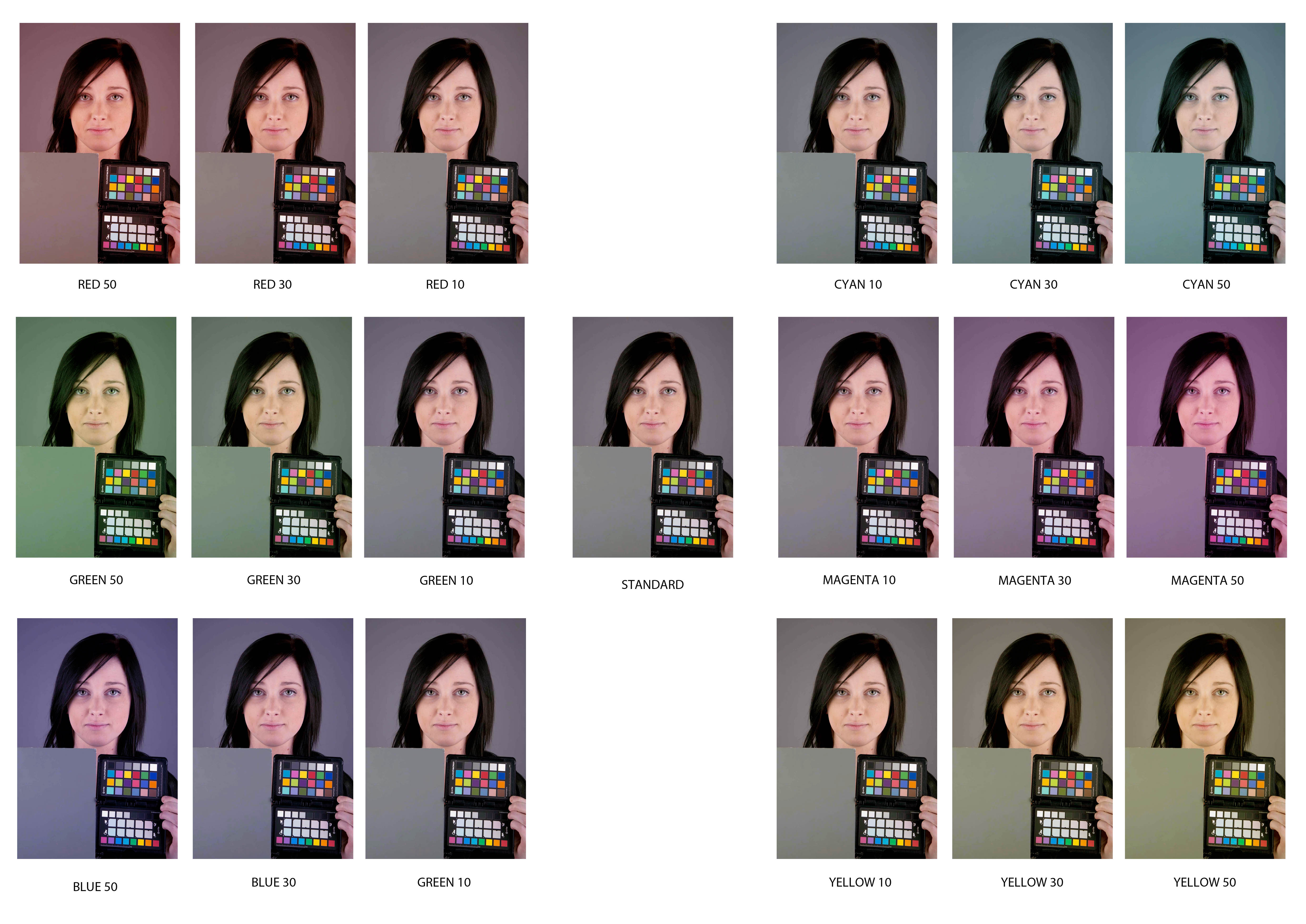

The trained eye reminds me of a lab I worked in in the 1970's and the durst printers had limited colour assessment and slope. We would do a ringaround, which was a set of prints with a colour correction in each one and then a density correction. A bit like this.
After doing enough of these type of prints, your eye is soon trained in to seeing the amount of colour correction needed.
