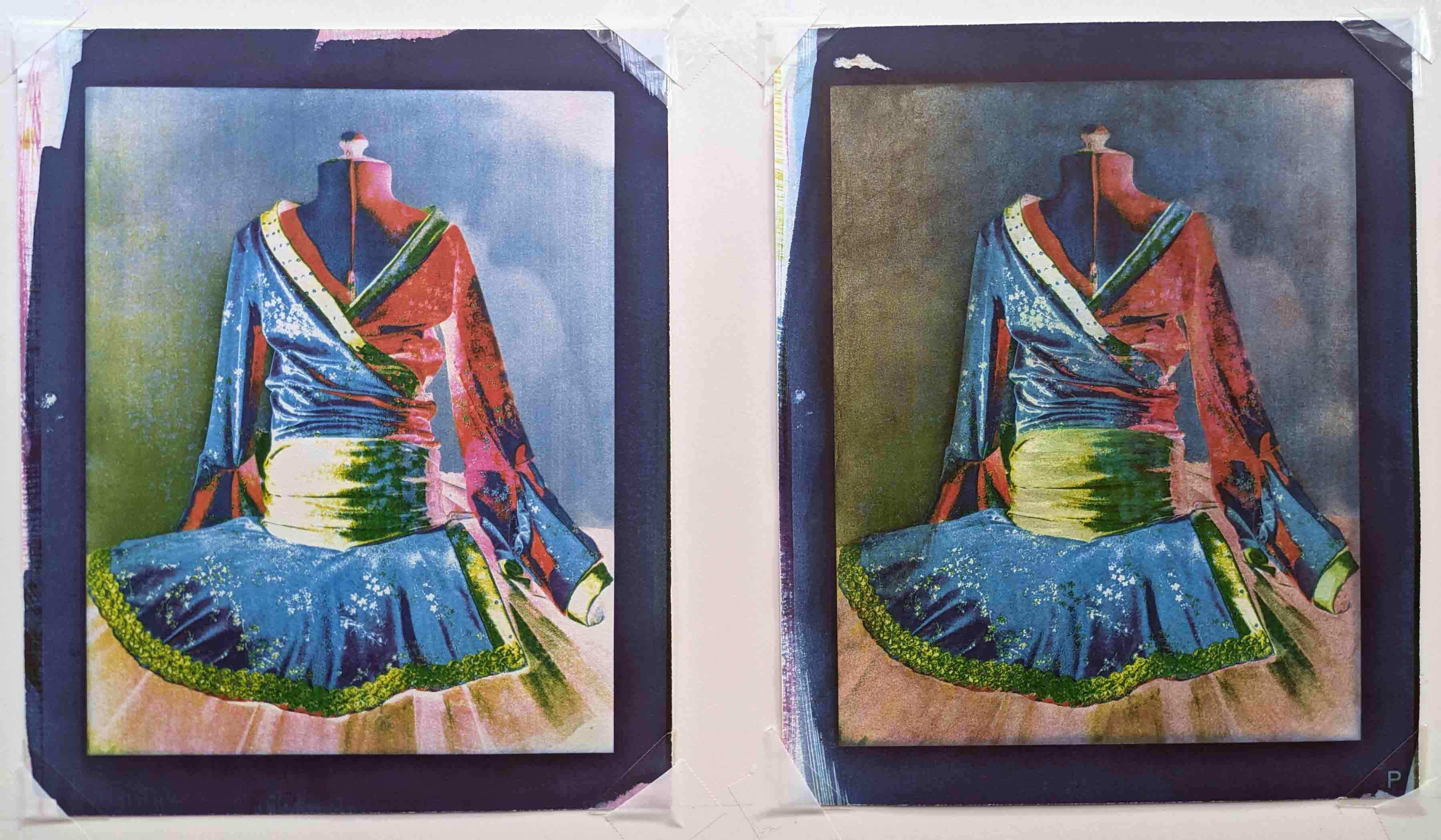

What you see here is a tri colour gum over palladium on Hahnemuhle Platinum rag, not silver but for I know our methods would work with matt or Art 300. We use the same Calvin Grier transparent pigments mixed with a bit of gum to hand brush work on the print. The image on the left is with no retouching and the image on the right is with retouching. I plan to build my skills over the winter to do this with all my solarization work, right now I have Anam (right hand maiden ) do the work with little input from me as to where to add the pigment.
View attachment 404943What you see here is a tri colour gum over palladium on Hahnemuhle Platinum rag, not silver but for I know our methods would work with matt or Art 300. We use the same Calvin Grier transparent pigments mixed with a bit of gum to hand brush work on the print. The image on the left is with no retouching and the image on the right is with retouching. I plan to build my skills over the winter to do this with all my solarization work, right now I have Anam (right hand maiden ) do the work with little input from me as to where to add the pigment.
Nice image Bob, a very striking effect with the colours.
