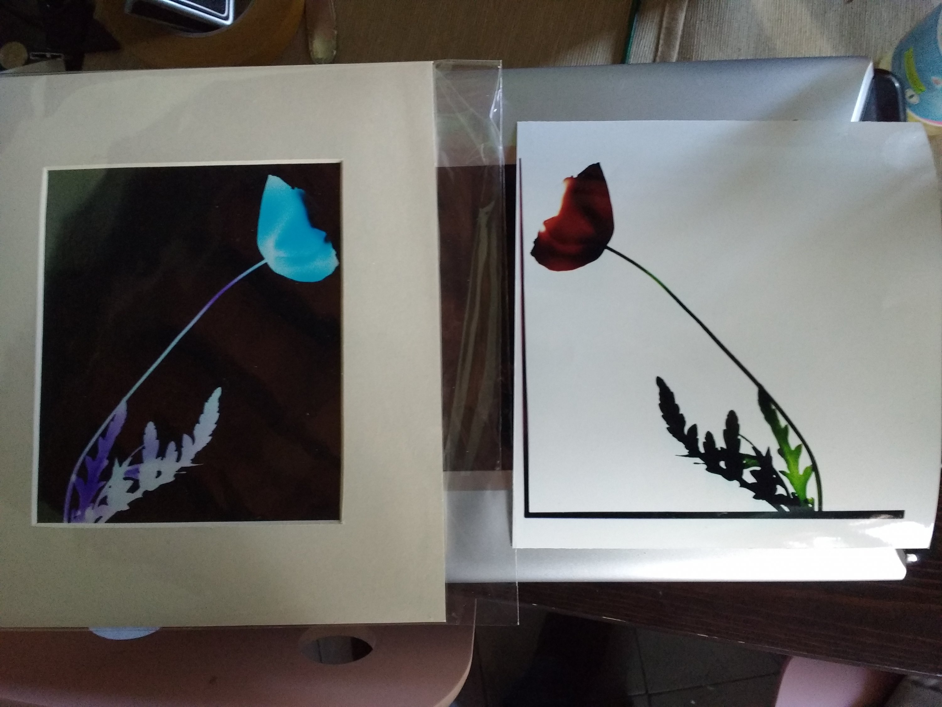

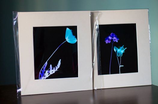

Just wanted to share these photograms I made with colour negative paper, it worked out really well!
and the positive as well

Is there a tutorial somewhere or can you explain how to do it?
If you print colour film already, it is quite straightforeward; You simply lay your subject on a sheet of colour paper under your enlarger and expose it to light than process it in standard RA4 chemicals. For light filtration I use a piece of colour negative film processed but not exposed (therefore transparent) and I set the colour filters for that film base. For exposure you have to do some tests, but you may get good results with a lot of different exposure times. To print the positive image you can put the negative one face down on a new sheet of paper and expose it with the same filtration. As for exposure time, again, a test is essential.
All of this could be done in black and white as well
Thank you, this looks like fun!
I like both versions. :smile:
But out of the two versions I really like the positive version of the poppy most = the graphic nature of the picture ie the saturated colours and lighting especially.
