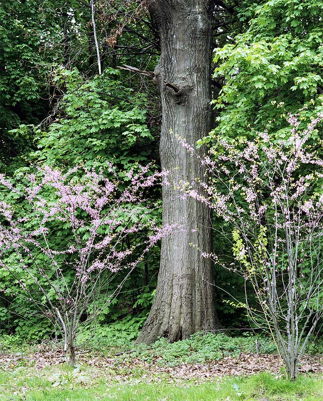

So here's one of the more successful portraits; again, this mostly works because of the narrow density range resulting from deliberately flat lighting. There still is a sickly greenish tint to the skin, which additional filtering would only fix at the cost of other problems (I tried),
koraks:
What a great post - the examples are clear, and the explanation even clearer.
And I can feel my teeth hurt when I see the crossover :smile:
koraks see a sickly green, you [Matt] see cyan and at worst I see possibly just a hint of the lower face by the chin area having a slightly different look than the rest of the skin but frankly were I to pass this photo in a window of a shop I'd see nothing wrong.
