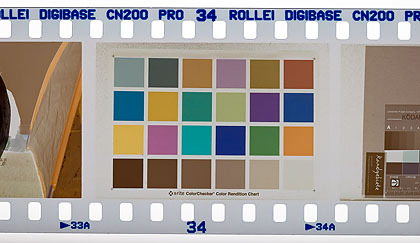

Let me rephrase; If you could exclude the orange mask, what would be the colour of a grey card photogrphed under 5500K with a daylight negative film?
as you can see, in a maskless film the grey remains grey. I assume this picture was shot under standard daylight conditions.
in the picture above, you may say that the grey is not neutral and there is a slight cast. But in my last experiment I didn't encountered just a slight cast, but a major colour shift. For example the picture shot on portra 160NC and printed with my method that came out extremely yellow was like it was shot under sodium vapour street light with daylight film.
Next time I order films I'll buy some of this rollei CN200 to see if I can figure things out better
