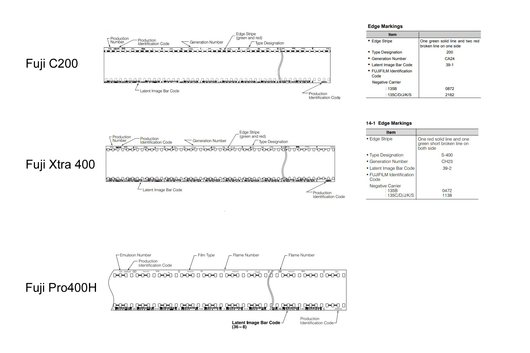

Film from fuji always has the thee color lines running on the edge band of the film opposite the DX coding. am I correct in the assumption that these strips serve as a sort of "sanity check" that the developer being used is actually forming dye molecules? Or do the strips serve as nothing more than just branding?

The little bar code at the bottom edge is a DX bar code. According to Fujifilm's Professional Film Data Guide brochure:
Edge markings are used for identifying processed film. In addition to edge markings, "DX" codes are also seen on 135-size color negatives. Code patterns are designated for each film type. The correlation between film type, edge markings, and "DX" and frame number bar codes is indicated below.

The OP does not refer to any digitized code, but to long lines running along the one or both rebates.
Through-going full- or dotted-lines have a long history, found at several manufacturers, but their function never officially explained.
Here a example From Fujicolor 100:
One red line troughout the rebate, a green one appearing only at intervals. Moreover at varying lengths, about at synch with each 24x36mm image only at one end.

Fuji calls theirs in their totality just "side line":
This sketch however looks different in its side line from the real Fujicolor 100, which I described above.

Fuji also call the markings, edge stripe and they are different for each film so I assume it is for ID.
See the image below and you will see that the markings for C200, X400 and pro400H.
Whatever the reason, it makes Fuji negs instantly recognisable.

I've always assumed this to be part of basic QC at Fuji where they can verify the C, M and Y density of these bands on processed negatives against their own database to identify (the cause of) possible problems.

Comparing lab developed negatives to home developed ones, if there was a difference or shift of colors, those lines would shift as well, independent of whatever happened in the camera.
Yes, that's correct. Gross deviation from processing parameters can be seen even with the naked eye when looking at these bands. Somewhat more subtle deviations can be assessed making prints that include the bands. Quite subtle errors can be tracked down with color densitometry. These bands can be quite useful if you shoot a lot of Fuji!

Almost every maker of colour film used a "system" like this to identify the brand and type of film to the person at the photofinisher who was making prints on a semi-automatic Printer. the old printers had to have a "channel" for each type of film. to make up for slightly different response between the photocells on the machine and the colour paper.
AGFA had colored squares and Ferrania had plus signs, Konica had Blue lines (to go with the blue film box I guess) and fuji had green or magenta stripes. every new version would have a new colour or position code. Wide or narrow, continuos or dashed etc.
this no doubt helped with private label film where their was no brand anywhere, but the operator seeing green plus signs could punch up the Ferrania Channel.
the Bar code also contains a reference with should be almost always be unique for each version, and the bigger printers would identify the type of film by that reference. the frame number is also encoded, so the printer could put the frame number on the back of the print for easier ordering of reprints.

note on the fuji examples above that the "in perforation" lines are different in length and width for each type of film, Long and short dashes etc.
