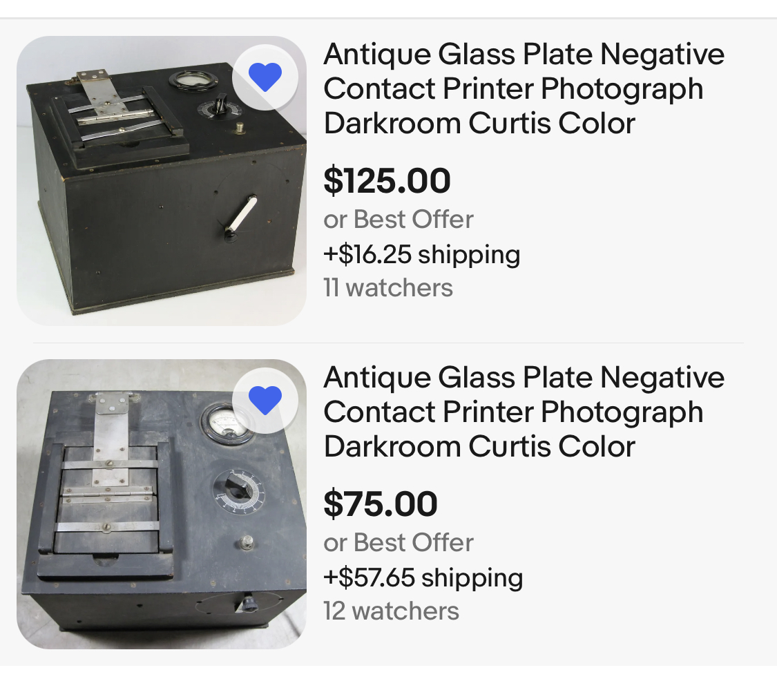

Two of the necessary contact printers are up on eBay right now if you want a proof of concept.

Bill, those posted objects have no relation to Curtis tricolor cameras anyway. They obviously made other things too, The Curtis method involved three different sheet film holders in the same camera which were exposed them all at the same time using R, G, and B color gel separation filters slid atop the film itself. A single lens was involved, and the image split three different ways via pellicle mirrors. Much of the use of such cameras PREDATES modern slide or chrome films, though they partially overlapped the early Kodachrome era.

Sure they for the purpose. They are color separation contact printers. You put a Kodachrome (Ektachrome or Fuji Velvia) 4x5 on the platen and turn the crank for the different filters.
Some of my old books have pictures of these things and tell how to use them.

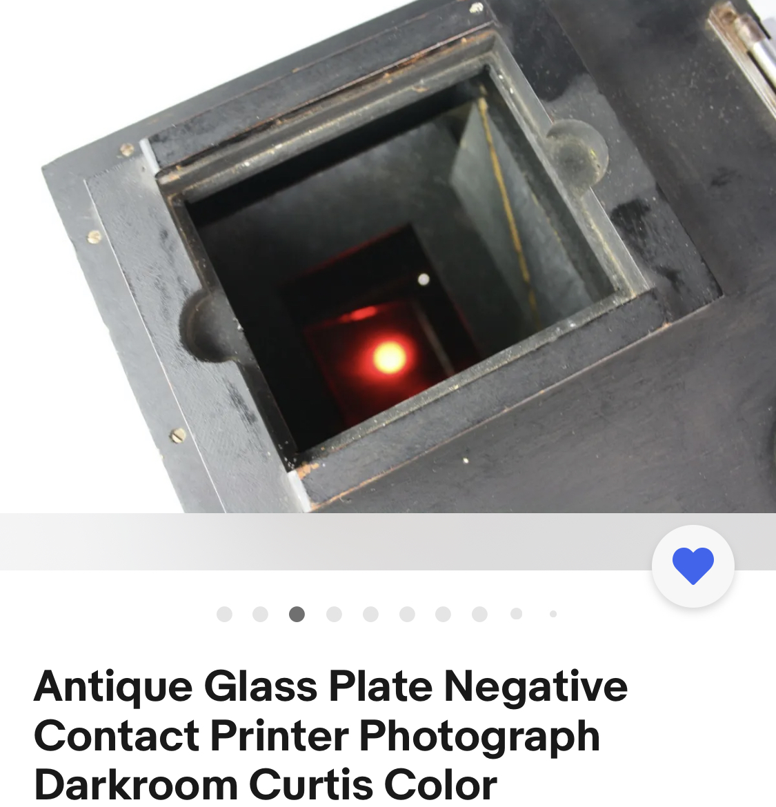

Oh. Now I see the color filter down in there. I'm more accustomed to seeing somewhat more sophisticated versions even from that era. Hard to say when those were made; but tricolor cameras were in use quite a bit earlier, and tricolor photography has been around as long panchromatic film itself has been. Those exposing boxes would have been considered antique by the time Velvia was first marketed - a difficult film when it comes to color separations, incidentally. Good ole Ektachrome 64 might have been early enough. But pro graphics and commercial printing houses already had way more serious equipment. The master teacher of the era was Bob Pace, himself of printing industry background.
Why those boxes didn't strike me as suitable for slide separations is because that would customarily have been done via RGB enlargements. I have seen the work of one individual who made 35mm separations by contact, and along with the preferred Super-XX pan film of the era, "grainy" in outcome, in the dye transfer prints themselves, which were enlarged, is an understatement.
