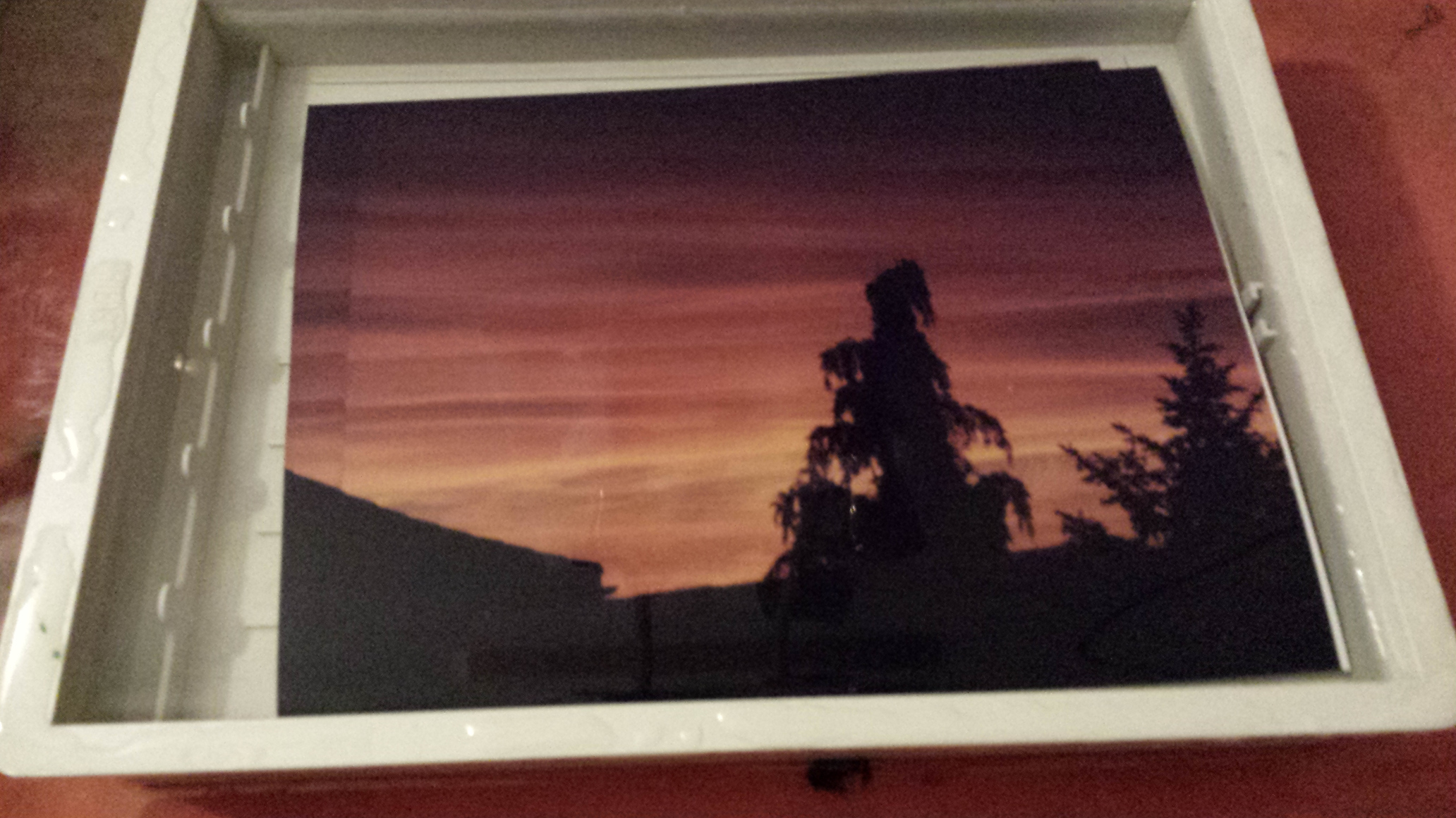

And I have to say I'm finally starting to make some progress, at least with some promising results. I could make a print that seems OK (the idea of using a safelight for color is superb)

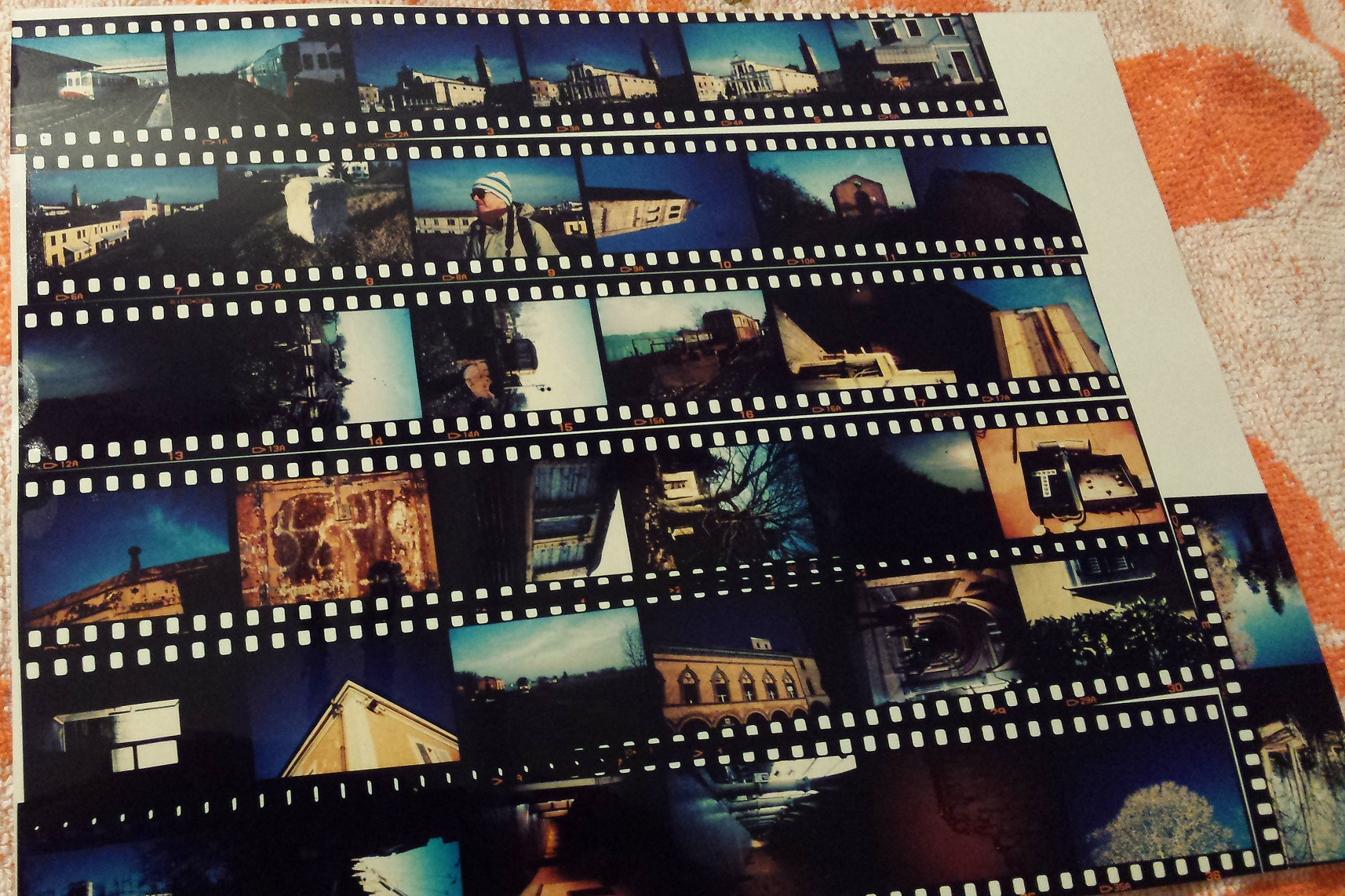

Also contact sheets come out well:
For some films color correction is still quite off but normally I can set it without many problems.

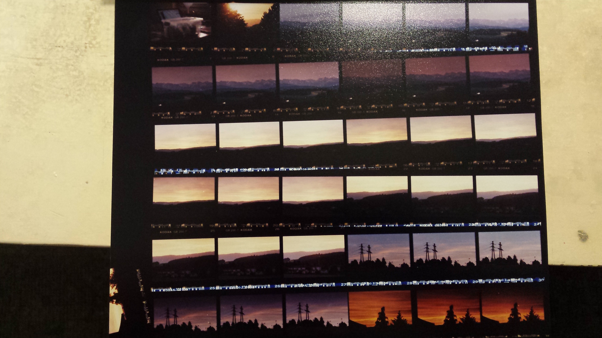

Lastly, at the end of the session, I did a small experiment - absolutely un-scientific and with the available stuff I had in the darkroom. The result is not perfect but it looks promising! Who can guess what I did? :smile:

It is RA4 reversal contact sheet of a slide :smile: I had lots of fun making it, and I was surprised how nice it came out!
