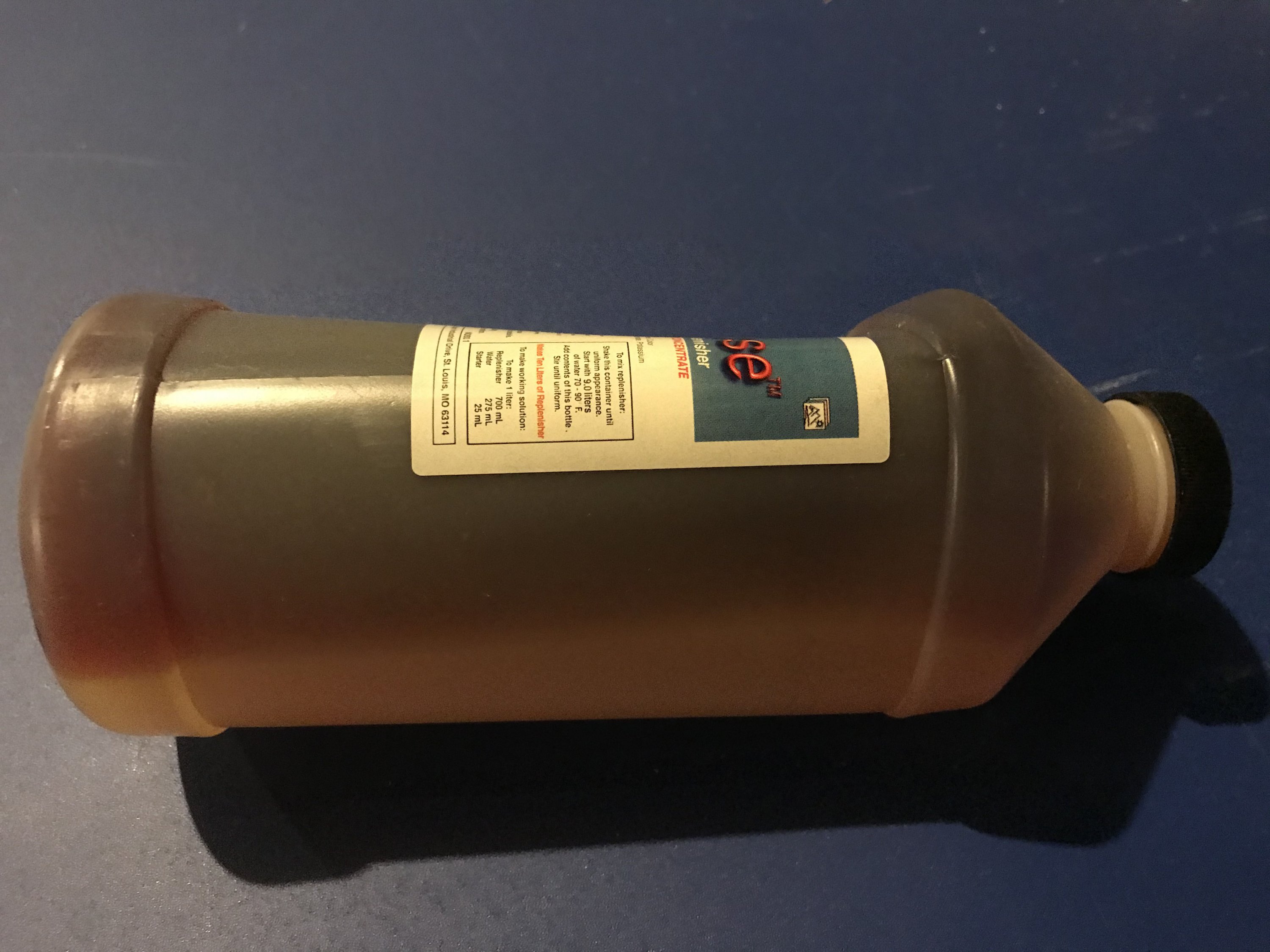

Here is the RA-4 developer, one solution, not parts. It has been like this all the years. Still mix well. Not sure if this is still good.
