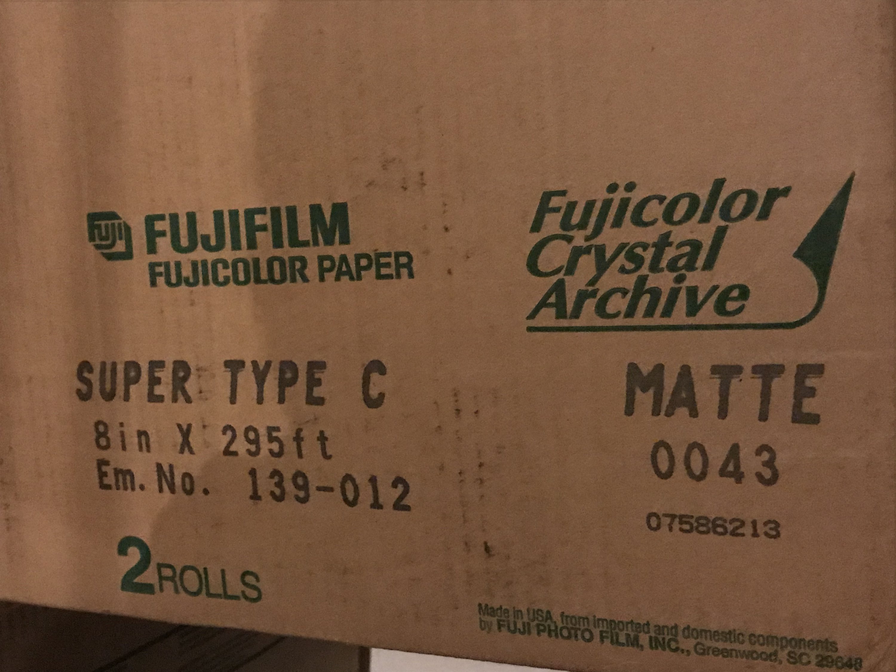

I get Fuji PIII and Super Type C. They were sealed and stored in basement.

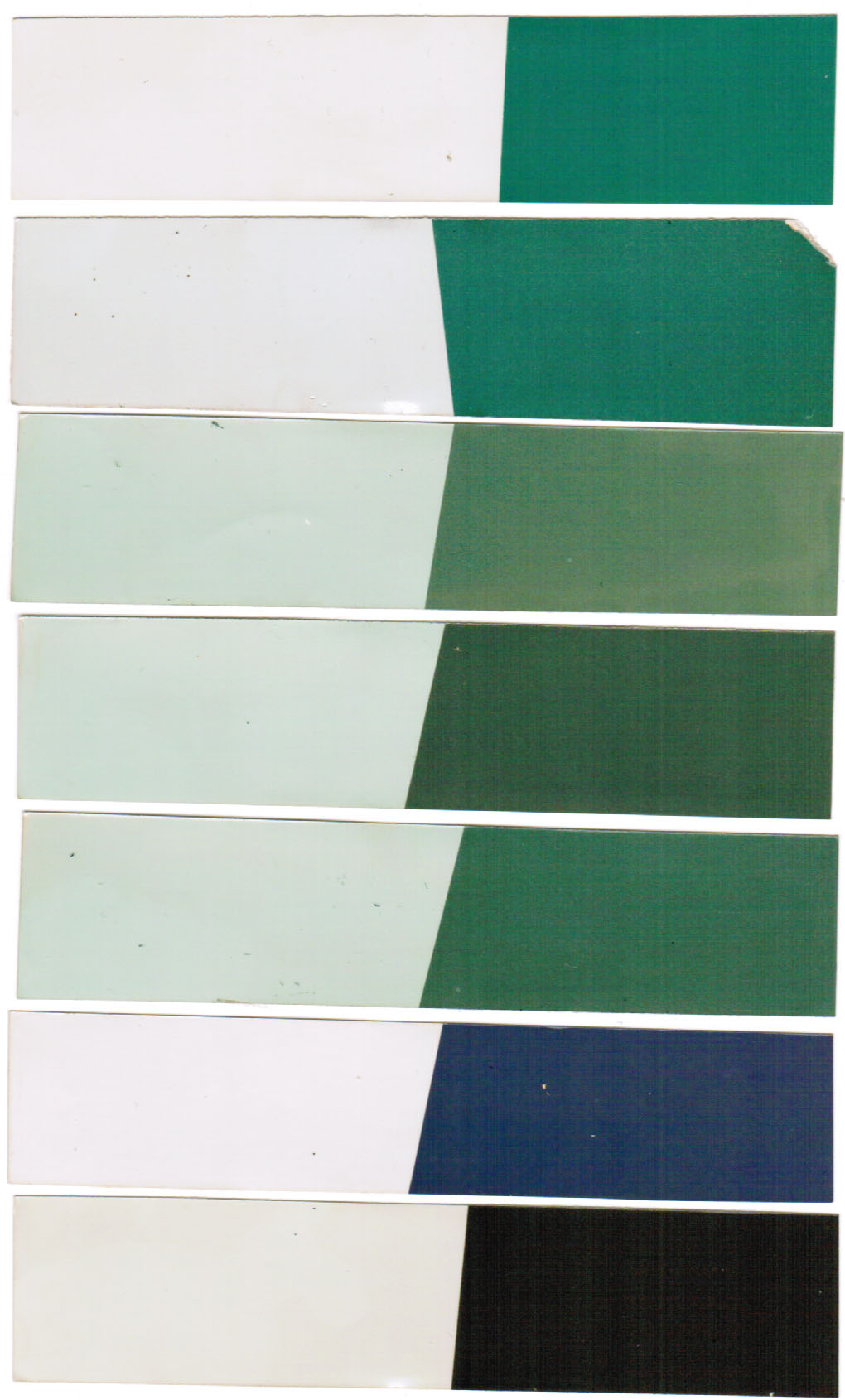

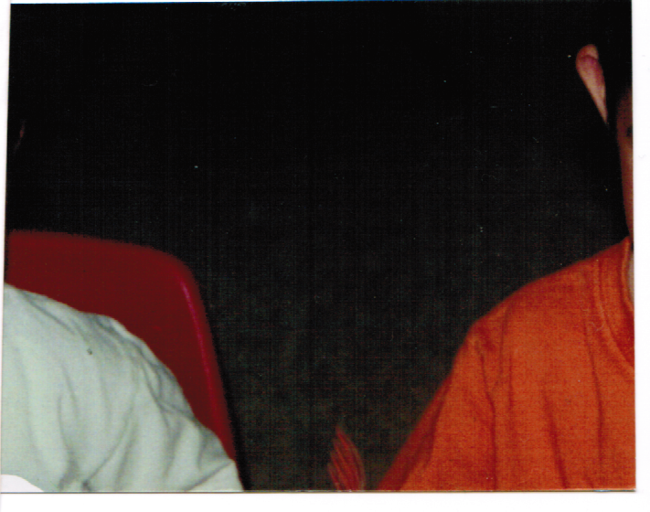

A few observations concerning your test strips:
* They're pretty small and show only a small part of the negative. That makes it quite difficult to judge and dial in colors. I generally try to make strips that capture the full contrast range of the image and preferably also the most relevant (to me) areas of color in the same strip. That way I am less likely to run into the problem that I balance OK for a particular part of the scene while the rest goes out of whack. Moreover, it's easier to balance colors if you can see how different colors in the image relate to each other as opposed to trying to match a single color. Often, as I get somewhat close to what I believe is a good color balance, I will print the entire frame to see how it ends up and then make minor adjustments as needed.
* The negative you appear to be using is a bit odd; I'm referring to the unevenness and the strange striped/checkered pattern - I've never seen something like this across an image so it makes me wonder what we're looking at and how this negative was made exactly. It doesn't look like a 'typical' negative.
* A negative taken under apparently challenging lighting conditions (with not a lot of light, and possibly a light source that deviates quite a bit from daylight) can be rather difficult to finetune in terms of color. I'd start with some negatives taken under daylight and made with sufficient exposure; these are generally somewhat easier to get the hang of color balancing. It also helps if there are e.g. a grey sky and/or clouds in an image as they generally tend to be fairly close to neutral and you can color balance on those and see how the rest of the colors snap into place once you get the clouds right (this is obviously less effective if you're dealing with setting/rising sun). Alternatively, a test negative as described by @MattKing can be very useful. This is generally a negative that contains the primary colors as well as some subtle hues that occur frequently and require careful balancing; skin tones have always been popular for this, likely because the human eye/brain is very sensitive to deviations from 'normal' in skin tones.
So in short, maybe consider printing some other (easier) negatives, and waste a little more paper on your test strips. Once you've found a good baseline for an easy negative, other negatives on the same kind of film will print well with fairly similar filter values.

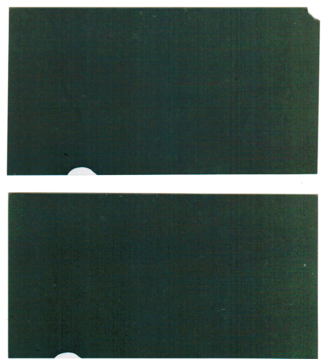

Those are the Jobo ColorLine "grey" calibration strips, not from any regular negative. The analyzer has the "grey" negative, initial color setup, test strip. Then the analyzer tests the new test strip and adjusts the new color balance. The analyzer only need to read 3-5mm area of the strip. When the color balance does not change any more, the calibration is complete. But the issue is that, the test at this time is not truly "grey". So the base color balance may not be correct.
After the color head is balanced, the analyzer can read the real negative and set the color settings for printing.
If you research online, you can see Jobo ColorLine 5000 and 7000. They are very advanced equipment.
I believe some commercial color printers have similar color "calibration". But they are more automate and better.

Oh yeah of course, you're trying to zero in a color analyzer. To be frank, I gave up on that as I found myself wasting too much time to my liking calibrating for different papers and then still having to run test strips to balance individual shots. Might as well skip the entire analyzer if you have to do test strips anyway, but that's just me. A friend of mine always used his color analyzer and wouldn't want to print without one. I tried two different ones, tested extensively and don't even think of using one now. I used the LiCi ColorStar devices BTW, an older one and a new model with separate cartridges for different papers. Very neat piece of equipment, but I just happen to not find it particularly useful myself.
