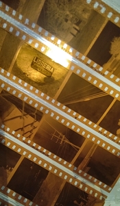

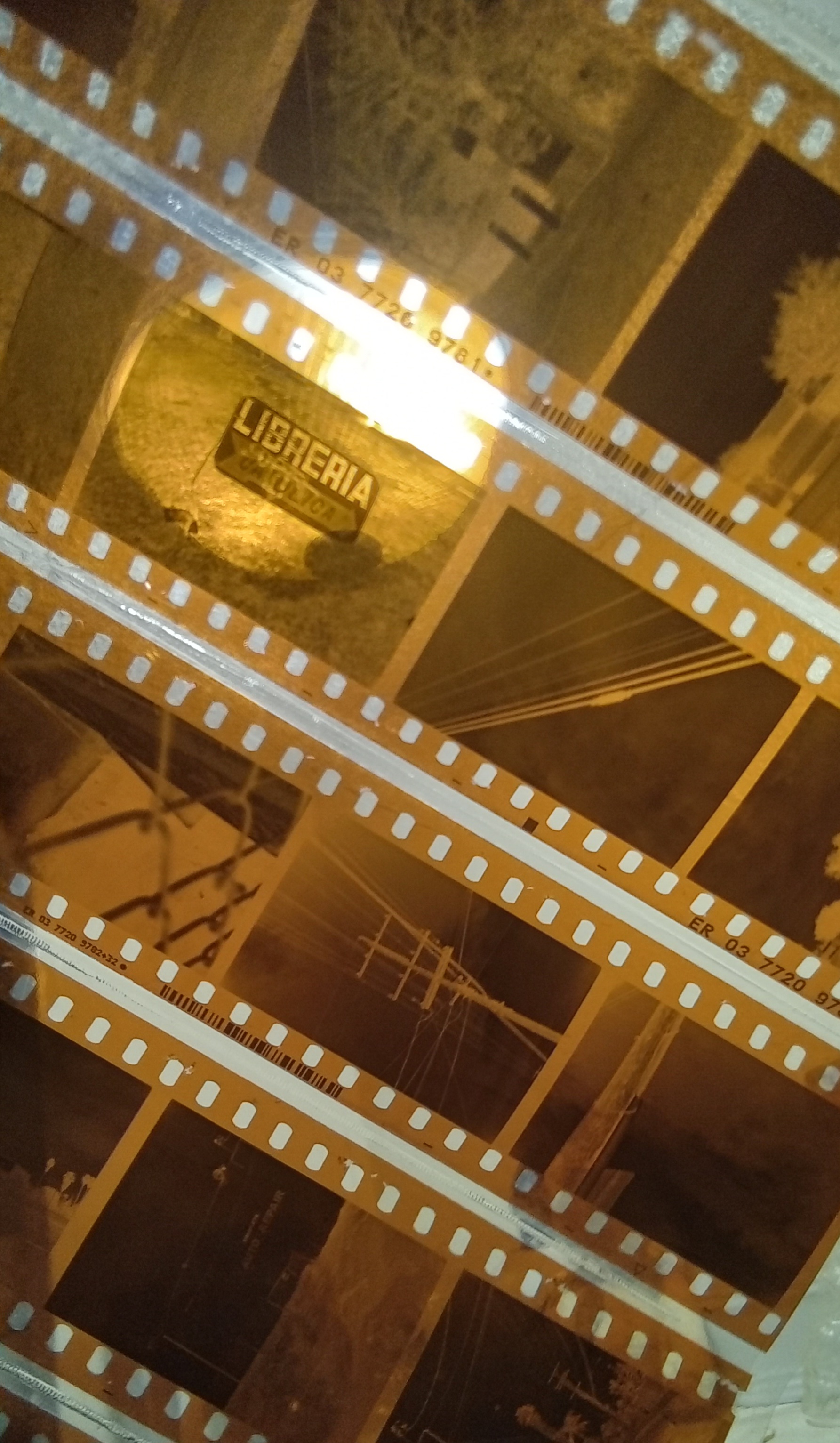

I recently did the same with a roll of Kodak Gold 200 of unknown vintage. Soaked in plain water for 5 mins, then Rodinal 1+25 @20° for 12 mins. It worked.
