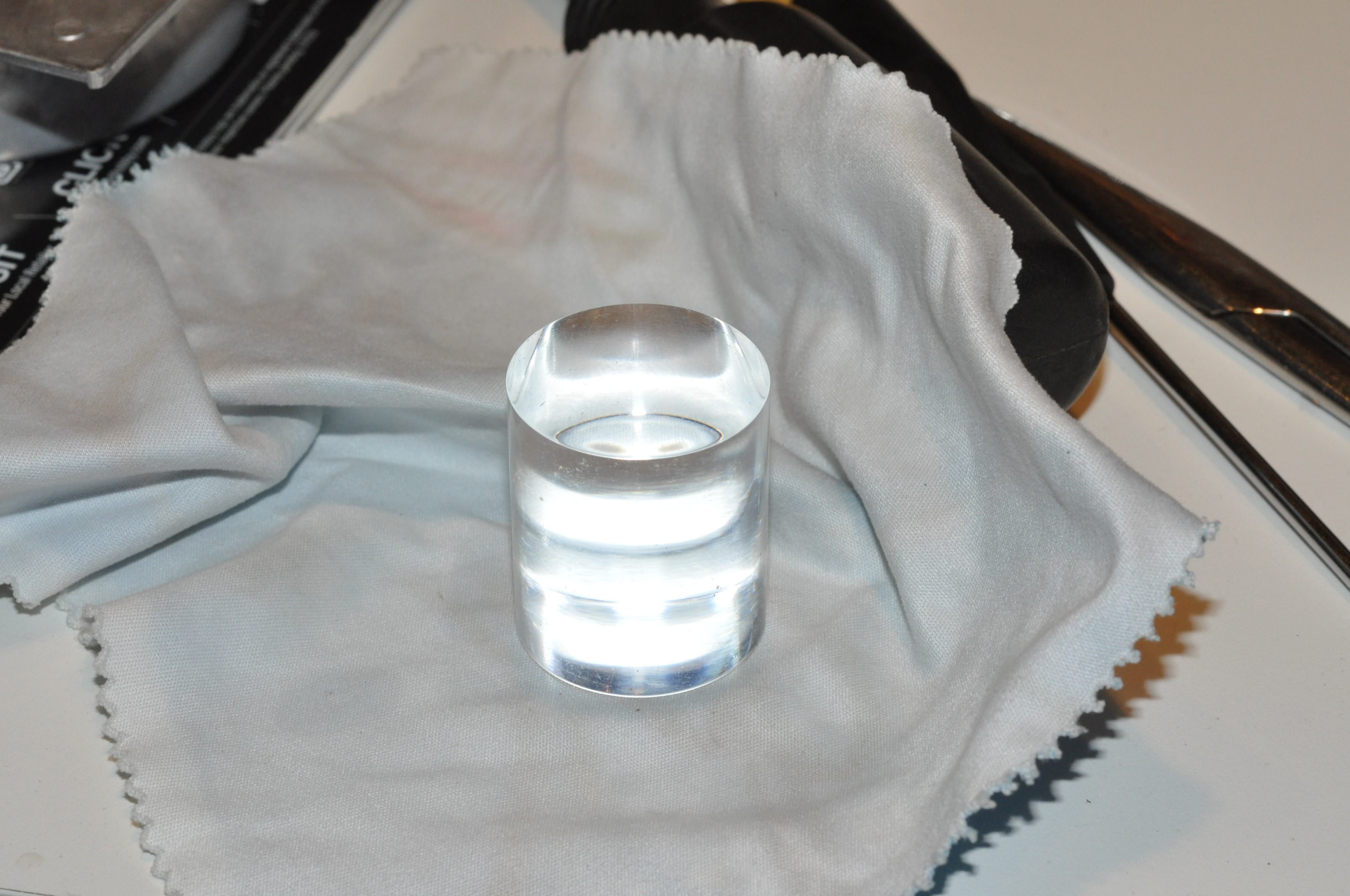

Fire the lasers into a light pipe. (for diffusion)
