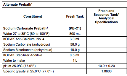

I've been removing the RemJet by allowing a 2:00 soak in Kodak's Sodium Carbonate prebath at 85 degrees F followed by four (or more) 106 degree (developer temp) water washes, each wash about 30 seconds vigorously agitated - as in swirl and shake. The first wash after the prebath will come out inky-black, the second much a clearer gray and the third will start to be lightly stained pink. Basically I wash until the wash runs clear. Four or five washes seem to do it. There is no trace of RemJet on my film, reels or tank.
I read about this procedure here or on one of the other forums where IIRC the poster was talking about processing Kodachrome. IDK if 2:00 is required or less time would work. It's just what I have used.
The prebath formula is listed on page 7-34 in the h2407 document. I am skipping the Anti-Cal but using distilled water. Interestingly, the prebath dumps out stained very pink with no trace of RemJet, and it seems you can reuse it. The RemJet dumps in the first water wash and I assume this is by design so as not to contaminate the prebath stage in a processing machine.
OK, I played around with this a bit today. I don't have a scale, but I figured this wasn't a precision formula since it just softens the RemJet... so I winged it a bit. Here is the formula we're talking about (click to open bigger):
I assumed that the chemicals weighed the same as water (incorrect, but close enough for this...) and measured out 1 TBsp + a little bit of baking soda, then measured out 3 times that amount of Sodium Carbonate (in the form of PH Adjuster for pools) and topped it up to 1 liter of water at 85 degrees. I took some scrap unprocessed movie film and soaked it for 2 minutes. As he said above, the prebath solution pours back out completely clear - the RemJet is still on the film, it's just very very soft now. Any water at all on it just completely removes it instantly. No chunks, no flakes, it just completely dissolves in fresh water and turns the water black, and goes away with the water. Nice!
Duncan
Photo Engineer
Apr 19, 2005
29,018
Rochester, NY
Duncan;
We laid our film on a lab counter top, emulsion side down and then just swabbed the back with a soft wet sponge.
Or, we used a sponge soaked in that carbonate solution, and then wiped both sides down with it twice, once with the wetted sponge and again with a fresh clean wetted sponge.
Either of these avoided having rem jet getting on the front of the film.
Also, please note that the pH may be critical as the alkaline prewet can change the response of the film in the developer due to a pH effect.
PE
Meaning that one would want to be sure the pH of the prebath is 10. Makes sense as the prebath would soak into the emulsion and thereby change the pH of the developer - at least initially, right? And I am also thinking, therefore, that time in the prebath would matter due to the amount of prebath soaking into the gelatin.
The developer calls for a pH of 10.25 @ 25 C, so if the pH of the prebath is much different from that is probably going to affect development.
From some of the suggestions above and in the control charts, pH is going to affect color balance and I suppose possibly giving the green cast that is showing up. 2:00 in the pre-bath may well be more than enough to loosen the remjet. I don't think 10 sec as called for in the specs will be enough for sink processing but maybe between 0:30 and 1:00? Guess I'll sacrifice a couple of feet and see what works. Using my soak and wash process at 2:00 I have NO remjet anywhere on the film so that will be the benchmark I will start with.
If the pH of the prebath needed to be adjusted, what would you guys suggest? My pH meter shipped yesterday. Maybe it'll show up today.
