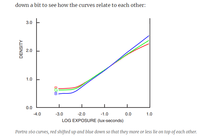

I really like the article, but wanted to add a small thing I noticed:
If you'd somehow manage to develop a color film in a process that would result in these curves, your main problem isn't going to be color balance.
From a practical POV, achieving D-Min that looks like this is next to impossible in a just slightly off process. A more realistic version of this plot would probably be something with ok D-Min, and then the blue record tanking between step 8 and 1, touching, or even crossing the green record.
Ah, thanks for your remark, but I'm afraid you may have misinterpreted this bit. Please let me clarify:
1: The image you quoted represents the neutral, "as intended" Portra 160 curves as published by Kodak in their datasheet, with one modification (see next comment). So this isn't something that represents a "slightly off" process - it represents a perfect process. As such, it's very realistic, except for one artistic liberty I introduced for the purpose of this illustration:
2: I shifted the red and the blue color curves so they overlay the green plot by means of a 'creative' manipulation to demonstrate how well (or, if you're critical, how badly) the color curves match for this film when processed properly. On a critical note, I perhaps should have removed the numbers on the vertical axis as they are no longer meaningful; they only apply to the green channel, but I moved the red and the blue ones to show the parallelism between the three different curves.
If we get a bit more technical:
Well, yes, the problem would be exclusively a color balance one and not a crossover one because no crossover was introduced in that illustration beyond the crossover that's inherent to the film itself, according to Kodak's very own datasheet! Moreover, the color balance problem would be extremely severe since I totally obliterated the absolute difference beween the curves (e.g. removing the orange mask etc.)
No, I havent misinterpreted it. The first curve you show, shows the correct sensitometric curves. The second example I quoted shows yours. If the Red Dmin Density is above the Blue Record Dmin Density, something would be seriously wrong with your process.
Are you saying that Kodak's published characteristic curves are wrong? koraks did nothing more than shifted Kodak's published R and B curves to align all three curves at the flat part of the curve.
I'm afraid you might have, though :smile: please see my earlier response.
The second example you quoted shows the correct sensitometric curves, deliberately shifted on the red and blue channels to show the extent to which the curves are parallel in a properly processed Porra 160 negative.
For a real-world negative to show the same red and blue shift, something indeed would have to be extremely out of whack and I think in fact that it will be neigh impossible to achieve this without resorting to dyeing the emulsion multiple times. The intent of the image was thus not to demonstrate a real-world example of crossover (those are shown as actual scans from prints at the end of the article), but to demonstrate the degree to which the color curves are parallel when everything is in order. The ensuing crossover examples are all exaggerated for illustrative purposes.
I hope this added explanation clears it up adequately. I still feel you misunderstood the intent and nature of the illustration, which I'm afraid got lost in translation somewhere, for which I apologize.
That's exactly what I meant.
"For a real-world negative to show the same red and blue shift, something indeed would have to be extremely out of whack and I think in fact that it will be neigh impossible to achieve this without resorting to dyeing the emulsion multiple times. The intent of the image was thus not to demonstrate a real-world example of crossover (those are shown as actual scans from prints at the end of the article), but to demonstrate the degree to which the color curves are parallel when everything is in order"
Alright, so...what's your suggestion then?
Hi, what's happening here is that the densitometer readings are just not representative of how the film is seen by a an RA-4 (light-sensitive color paper) paper. The status M densitometer looks only at three narrow spectral zones. Whereas the color paper has much broader spectral sensitivities.
My considerable experience with Portra 160 film, shot with pro-grade electronic flash, is that optical prints (on the appropriate pro papers) have no problem producing neutral gray tones over a wide range of exposures. The implication being that this film, as "seen" by the color paper, has three neutral color "records" that remain parallel over a wide range. It's only when they are "seen" by something like a Status M densitometer that they are no longer parallel.
The Portra data sheets also show what they call "Spectral-Dye-Density Curves" for a "Minimum Density" and "Midscale Density." Looking at these one can see how "wiggly" the curves are, making the point that the one's "sampling results" can be very dependent on the specific spectral characteristics of the "device" used to "see" the film.
In Giorgianni and Madden's book, "Digital Color Management..." they show examples of some arbitrary color-neg film where they compare characteristic curves made with a densitometer vs what they call "printing density." The densitometer curves are similar to what you (koraks) used for your example of color crosses. Whereas the "printing density" curves are parallel. (As I recall Hunt's book, "The Reproduction of Colour" has similar examples.) These were both well-known color "experts" from Kodak, so one might presume that this is likely reliable information.
The "solution" to this? I guess one could accept that densitometer readings are not a good way to make precise judgments about color-crossover problems in optical printing. The ideal solution would seem to be to transform the densitometer readings into so-called "printing density," but this would not be simple.
Fwiw I did read through your writeup on color crosses, and aside from this issue it looks fairly good in the case of neutral gray reproduction. But... there is a much bigger complication for non-neutral colors. Most of my experience has been with a large portrait chain where we put a lot of effort into high quality color. We did extensive testing in film and paper combinations before committing to anything new. Aside from a few limited tests we always stayed with the Kodak professional portrait film of the day (a limited test could go so far as to put a couple hundred full-time portrait studios onto a specific film, with an individual cine processor dedicated to that film; a replenished system varies slightly with the specific film byproducts).
Anyway, many years back we observed that it was possible to have a good neutral gray reproduction (no color cross) with "bad" (our judgment) color crosses in skin tones. And vice versa... good skin tone reproduction but significant color-crossover in gray scales. So we concluded that fairly extensive practical testing was also necessary for a thorough film/paper evaluation. Sensitometric testing, alone, was not enough. When Portra film was introduced (late 1990s?) it was very good in all these respects. But... I can't say what happens when shot outside of nominal 5500K color temp. There are multiple finely-tuned interactions between color layers during processing, so if one of the color layers is unbalanced with respect to the others I'd expect some disruptions in the color reproduction. How bad, I have no idea. From what I read on this forum I suspect that the great majority would not notice such things - it is something of a fine edge. Anyone who used to be satisfied with run-of-the-mill mini-lab prints would probably not be remotely bothered by any such issues.
One might wonder why a chain studio outfit would worry about such things. Well, it's the old rule of QC - why try to control things that you can barely measure? Tolerances tend to stack up, often tending to cancel each other out. But sometimes they mostly stack up in one direction or the other, the result being some out-of-spec product. So, especially with very large volumes, it can be cost-effective to control things to what most photographers would consider unreasonable levels.
Here's an older post describing part of our film testing routine...
Ps, the preview doesn't look quite right, but the link is...
@Mr Bill thanks for your thoughts; they're very clear and to the point as always! The only thing I'd add is that your views are a (very welcome!) practical perspective that I feel very nicely complements the more theoretical and basic approach I took in the blog I wrote. My blog, indeed, only intends to answer the question "what is color crossover and why is it called that way", by means of a few mostly synthetic and exaggerated examples. Hence, your additions are very helpful in answering a few questions (e.g. the meaning of the divergence of the curves in the Kodak datasheet) as well as provide a useful warning that the issue of crossover is sometimes more complicated to figure out in reality than in my 'digital lab setting' experiment.
Indeed, and partly overlapping ones, at that, whereas status M likely (haven't looked into it yet) considers a couple of wavelengths that are actually separated.
