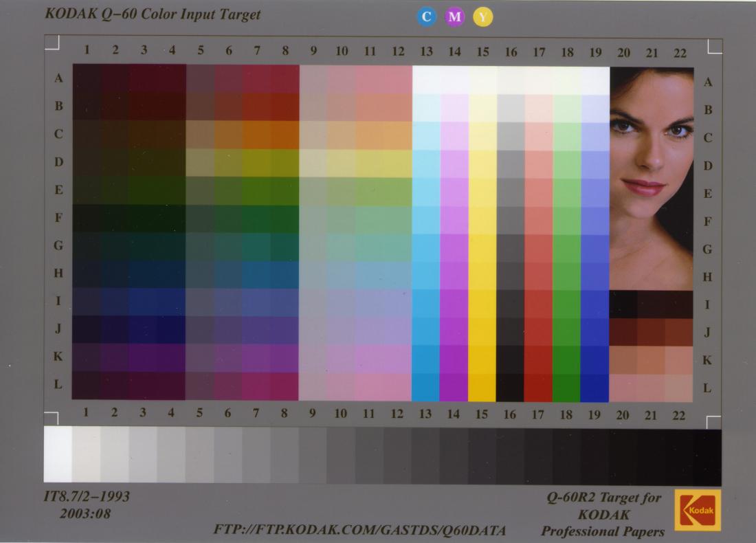

Photo Engineer
Apr 19, 2005
29,018
Rochester, NY
Very good inexpensive chart
I say again, this one is not bad. It is also inexpensive!
PE
Lee L
Nov 17, 2004
3,281
Ron,
Ran a quick check and found the Q60 5x7 target is listed as discontinued by the mfgr (X-rite/Kodak) at B&H.
http://www.bhphotovideo.com/c/product/520747-REG/X_Rite_TGT_RKIT857_Kodak_Q_60_Color_Input.html
although they do have it used or demo in a set of 35mm film, 4x5 film, and 5x7 print targets for just under $200.
colormanagement.com has it for $57.00, RPImaging for $47
I'd guess there are still some in the retail channel for purchase, but you may have to look around. I haven't found any official Kodak info on discontinuance or a replacement product.
Lee

Photo Engineer
Apr 19, 2005
29,018
Rochester, NY
My instructions with the chart say it is to be used to calibrate scanners. I've used it to set my scanner up to scan reflection prints. It seems to work with film scanning as well.
PE
