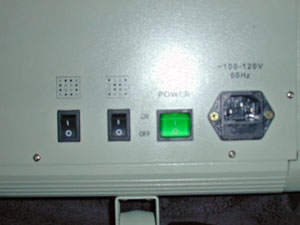

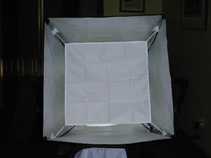

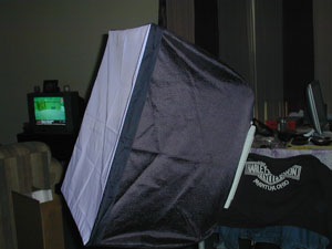

Output is similar to 1800 watt tungsten but with a color temp of 5000K. for 125.00. 16 30watt spirals. (there was a url link here which no longer exists)

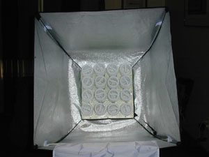

RobertP
May 11, 2006
1,190
ULarge Format
You can also control the array pattern when using just half the lights. (there was a url link here which no longer exists)
