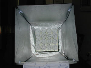

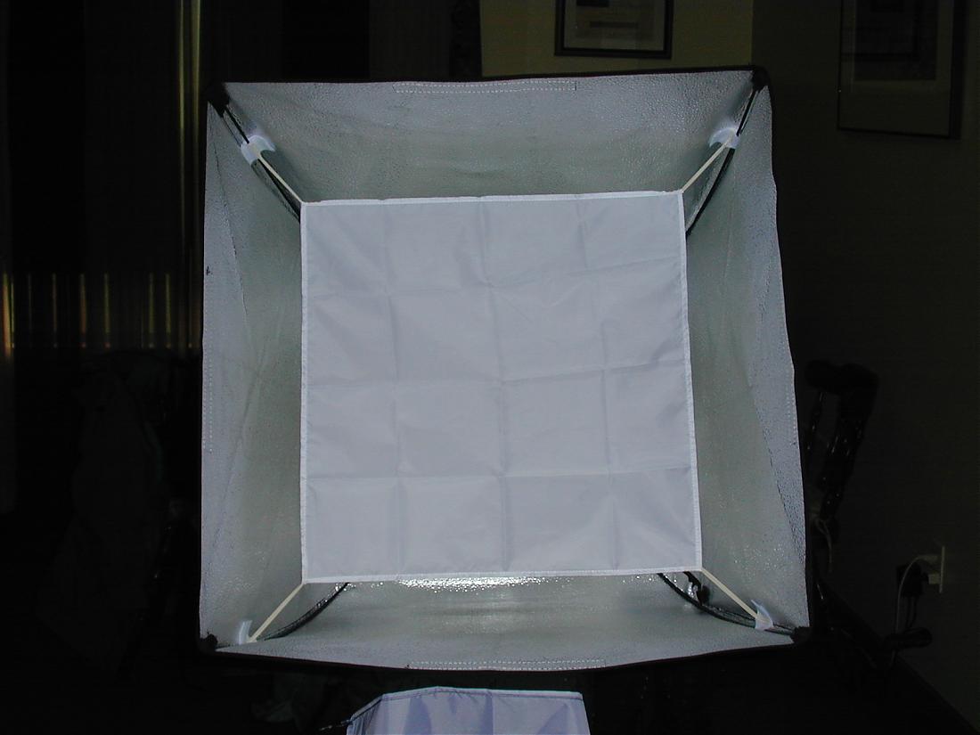

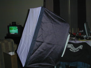

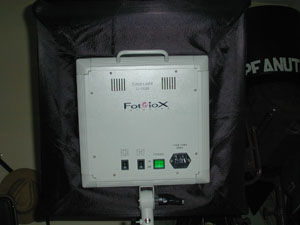

Yes 1000 bulbs is the place to buy them. They are the cheapest. Although in my last order to two more of these lights they sent half the biulbs that were a different size. Everything was the same except the newer bulbs they have in stock are 2.7" wide as compared to 2.3" wide which makes it impossible to squeeze them into this tight array. I called them and they are working on sending me the right bulbs. Here is a pic of the light with the right size bulbs. They are 30 watt 5000K . The light is rated at having the same light output as a 1800 watt fresnel. They are bright.... DSCN0044.jpg
DSCN0045_1.jpg http://www.apug.org/forums/attachment.php?attachmentid=8870&stc=1&d=1193249742http://www.apug.org/forums/attachment.php?attachmentid=8869&stc=1&d=1193249479

When it rains it pours. I just received the soft boxes last week for two more of these lights because they were on back order. The new ones have the Fotodiox emblem on them. I just got them out and was assembling one of the new ones and ran into a manufacture defect in the front baffle. The black material the slides over the soft box is the right dimension where this black material meets the white 24" but at the other end ( the side that enters onto the soft box) they tapered it down to 22" it collapses the soft box somewhat. I called and they checked their new stock and concluded that they would have to be remade which can take up to three months. They offered to take the light back if I didn't want to wait. I'll just take the corner stitches apart and add material. And they will send new baffles when they come in. This is why I didn't want recommend something before really having a chance to use them. The light is fine its the softbox that has the problem.
