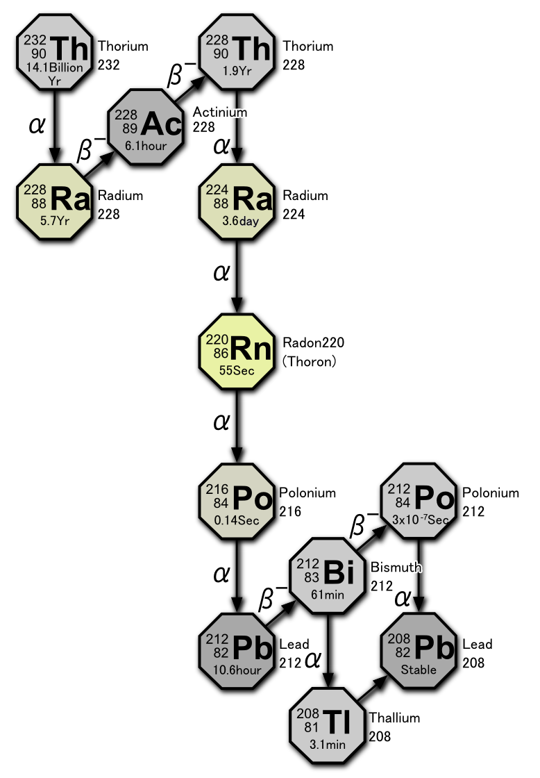

Since the decay chain from thorium emits alpha and beta radiation you are good with a piece of paper :wink: Those are only dangerous in direct contact like if ingested/inhaled and are stopped within few cm in air. Alpha wont penetrate a piece of paper and beta will be stopped by glass or at last something in that category.
Soeren, this would be true if all decays were to the ground state, but they are not and so there are gammas from de-excitation. In particular thallium-208 produces an energetic 2.6MeV gamma, which requires quite bit of shielding. BTW, this line is used to identify thorium ore. In any case, I doubt there is enough intensity to fog film.
And just to come back to the OP: there are not enough of those either to be harmful, assuming your not carrying it in your pant pockets 24/7.
The decay chain is offcource simplified but still the conclusion remains.
