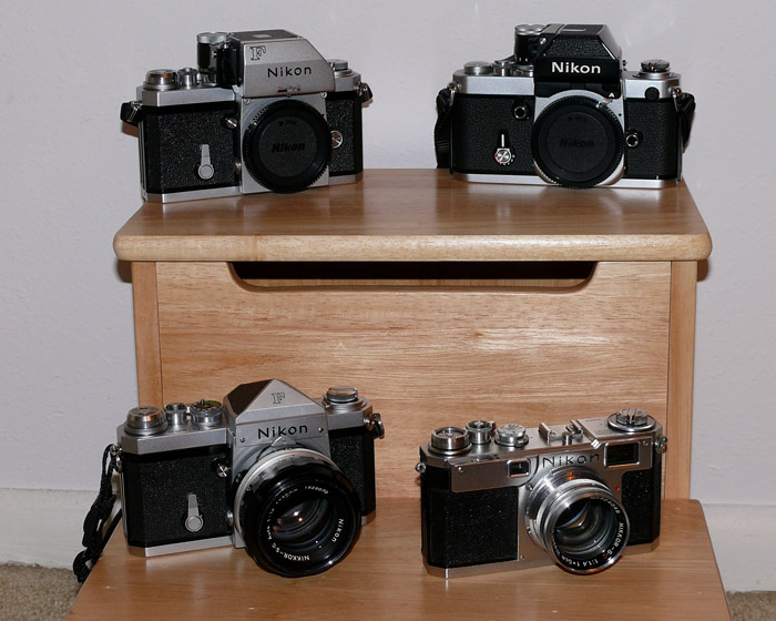

I see the F. It's pretty. I guess the D must stand for something else besides double. I was picturing something with maybe 2 lenses.
No, I think it probably stands for "Da camera Dat took Dis picture..."
