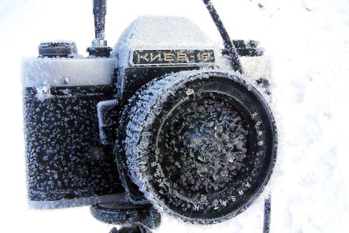

I've shot all kinds of cameras in temperatures down to -40 without any issue. I mean sure, if you left the camera out on the tripod all night it would freeze up but in normal use they should be fine. he biggest challenge is keeping yourself and your fingers warm. Pentax cameras work fine, I've shot everything from a K1000 to my 645NII. Lithium batteries are basically unaffected by cold, if your camera uses non-lithiums it might be an issue.
A local aurora photographer has shot film for years, up until very recently, mostly in cheap Russian 35mm cameras with various brands of 800 speed film.
Hazards of Aurora Photography by David Cartier, on Flickr

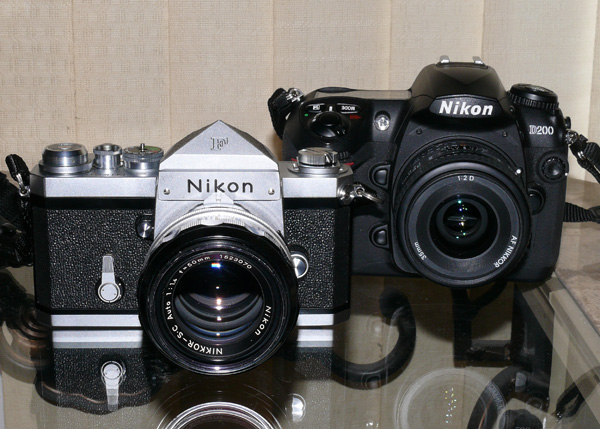

A DSLR? What dat is? Is that a double SLR that like, takes 2 different pictures at once?
It's the black, rectangular object behind my pretty F...

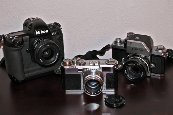

...and this even bigger, black rectangle behind my other two pretty silver cameras.
p.s. The one in the middle is also a film camera...
