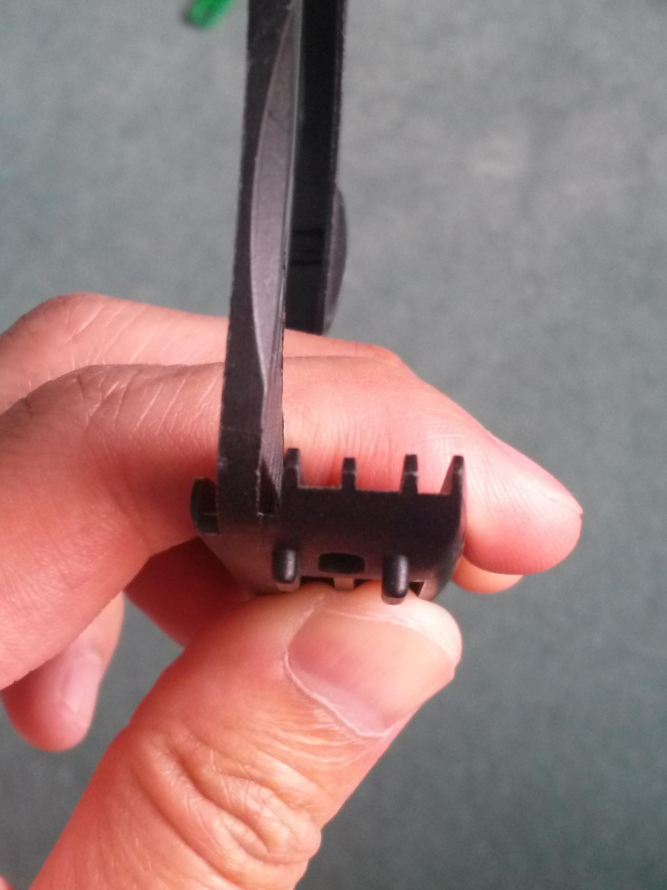

Hi all - over the Xmas period I had more time so I watched some Youtube videos re: landscape filters by Lee. Yeah .. my pictures do look too average and I should use my filters that I own now a bit more often.
I read on B&H and it says it takes 3 square filters and a crinkle cult round filter so 4 filters together. Is this true?

I have 2 holders. P wide angle that takes only one slot in square filter. The P standard version that takes 3 square filters, so I can attach a special polariser on the outside?
I have 77mm adaptor for it. I have step up rings with my other lenses (for my 35mm system at present).
For the 35mm system I thought about a GND filter, a CPOL and a standard (solid) ND for waterfalls ot smooth out the water.

As I am looking at going with larger formats. It seems like the Cokin P with the wide angle holder vignettes at 18mm but clears at 20mm - only allows 1 filter at most case. The standard holder doesn't clear until 24mm - for 35mm SLR.
Are larger formats an issue with vignetting since the focal lengths are longer? I mean at the extreme a Pentax 67 with a 40mm is that an issue?
I am just reading about the 100mm filters now. But it seems like at the 35mm system 16mm FL it can only use the Lee wide angle holder with 2 slots and one cannot use the 105mm CPOL filter. Then the only alternative is to have the CPOL on inner slot using a Singh Ray / Cokin brand Z size drop in Sprocket.
