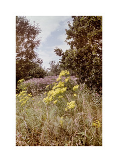

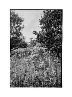

So if I understand this correctly, a year after you developed a roll of film, you developed it again, and got color after you originally developed it as B&W (I realize it was color film)? That's amazing to me. I'm a real novice when it comes to self-processing, so to me, that's mind-boggling! :crazy:

You have it exactly right.
It's not a new technique, in fact I think there's an old Kodak document about how to do it.
Developing and fixing C41 film in chemicals normally used for black and white doesn't destroy the dye couplers & whatnot that generate the colour when it is processed in a proper C41 process.
So long as you can first recover Silver halides from the silver image on the film (which is what the rehalogenating bleach I mentioned does), a colour developer can then be used to trigger dye production again.
The image is somewhat degraded, but as you can see is just about acceptable. Bear in mind that my example image wasn't redeveloped in a correct C41 process, so it might be possible to get better results.
I find it interesting in and of itself, but there is a practical application: From time to time people find unprocessed old colour film (usually requiring an obsolete colour process) and ask the best way to develop it. I've seen it suggested a few times on APUG that it is first developed in black and white chemicals to recover any images (and scan or print) that might be there, before trying any colour development.
