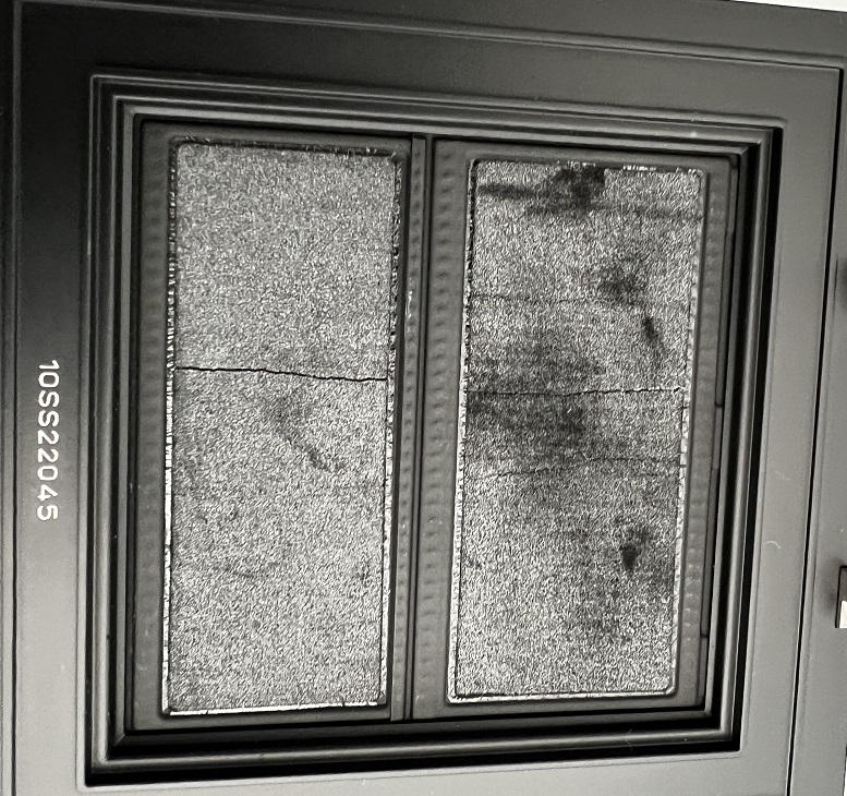

Here's another question related to storage. I recently acquired this Hasselblad 501CM that was made in 2000, but had been stored almost since that time. Here's what the rear shutter (is that what it's called?) looks like. Is this a concern?

Looks like mildew to me.
The camera was stored in a room with the humidity around 30%. I don’t think it’s mildew.
I looked at a bunch of eBay listings for the 501CM from Japanese sellers. In the majority of them, the auxiliary shutter looked just like mine. I suspect this is a common thing with these cameras.
Perhaps one of the Hasselblad experts on here can give an opinion.

What you see in that image is the special Hasselblad coating failing with time. I use Aerospace 303 to treat those surfaces and any further degradation ends. It’s a sort of poor palpa coating that was supposed to reduce reflections in the mirror box area. I have yet to see any late Hasselblad NOT have that issue.
Interesting. How do you apply the Aerospace 303 and how much do you use? Is it a one-time treatment, or does it require additional applications?

When I use Aerospace 303 on the internal non-reflective surfaces of my Hasselblad cameras all I am doing is trying to slow down the degradation of the palpas surfaces. I take everything off that is removable, like lenses, focusing screens, etc., and then do it with the mirror locked up, and then with the mirror down. I use q-tip wetted with the 303 but don’t go crazy with the stuff. Ultimately, I think the palpas stuff is drying out so all I want to do is refresh it a tiny bit. I think they most important surfaces are on the shutter both on the side facing the film backs, and the side facing the body. I’m not a Hasselblad repairman, by any means, but it seems to help. Perhaps a real repairman can jump in And say “oh, no!” Of course, it does not attract dust or any other bad stuff.
