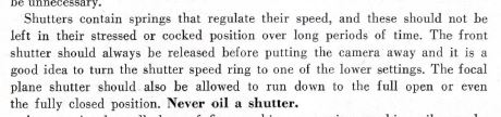

You keep your LF shutters cocked; why? Their natural state is un-cocked until being used!
Copal, in their size 0 and 1 shutter "instructions" (that many of us never got when we bought a lens already mounted in shutter) is silent on the topic of storage... supporting your French proverb. :smile:
I did find a definitiive manufacturer statement on this topic in Graflex's Pacemaker Graphic Instruction and User Manual. Pacemaker Graphics used several different leaf shutters as well as a focal plane shutter:
And the same regarding the focal plane shutter in their Pacemaker Crown and Speed Graphic Guidebook:
Well, when the LF central leaf shutter is in open position, I consider it as somewhat cocked, and I caught myself repeatedly to have left it that way for a rather long time, and apparently without any harm at all. Even fully cocked, they didn't suffer...
That's something I used to forget to check in the heat of the fight, when I switch lenses on the go (Linhof), and coming home late at night and have to process the film immediately for delivery the next morning.
Anyway, this is professional gear, and it is meant to be hauled around, withstand 'intensive' use in unfriendly environments, and, sometimes, typical unintended abuse (but loved)...
Hasselblad at least, cocked or uncocked!
And I think, but not sure, that the Prontor-Press shutters are always in a kind of a ready-to-fire position (=cocked?).
BTW, I wonder if the Graflex uses an US made Wollensak (leaf-) shutter, which might considerably differ from the German Synchro-Compur and Prontor shutters as used in the Hasselblad or the Japanese Seiko and/or Copal ones in the Mamiya and Fuji?
Oh, I never ever oiled a shutter!

... Oh, I never ever oiled a shutter!
LOL... don't get me started on that topic! Internet "wisdom" that keeps getting repeated over and over again is that many shutters were intended to be run dry (without lubricants) because of statements like this in USER manuals, without regard for the easily proven fact that the SERVICE/REPAIR manuals specify a robust lubrication plan. So often it is written on the internet to "RTFM" yet some folks can't seem to read the manual themselves, or read the correct manual before offering "authoritative" advise. :wink:
PLEASE, don't get me started on that topic... I get easily annoyed by internet blow-hards who just keep repeating stuff they cannot support with authoritative sources. These two specific debates have been going on for decades in the same vane, over and over again. Generally, the "expert" cuts and runs rather than supporting their point, only to pop up again later repeating the same "wisdom".
I'm not familiar with Prontor-Press and always thought that they were like a double-action pistol - cocks and releases upon pulling the release. I assume that on how my antique Kodak TBI shutter and an Alphax shutter recovered from a Ciroflex TLR works; I could be wrong, though.
The bottom line, which you suggest, is that these options are minor details compared to other factors that are more likley to cause equipment damage. "on n'est jamais mieux servi que par soi-même" :smile:
