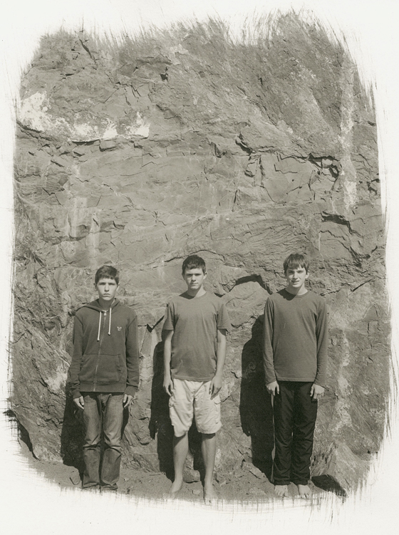

Sometimes it is fun. Platinum print, 11x14 negative. Next time I'll keep Alex's feet in the image area!
