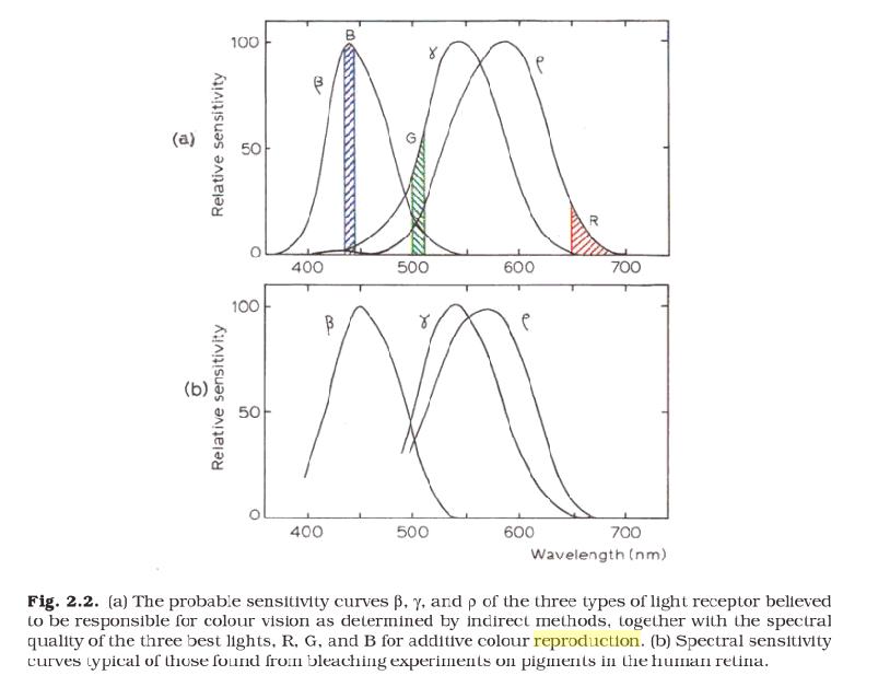

Sensation Curves, Dye Transmissions, Retinal Response of Dyes
Here are some figures from Hunt's The Reproduction of Color.
1) The first graphs show the sensitivity curves for the cone's in our eyes.
How do you get the data for a graph such as the first one?; by "indirect" methods. Was Maxwell the first to investigate these values, or did Young & Helmholtz do any testing of their own?
Since each human has a somewhat unique response to color, what are the deviations from this mean? Wouldn't it be interesting to characterize sub-sets of color-vision, and then make photographs that would cater to each set? Imagine having 3 different prints, optimized for 3 (just as an example) different vision-types. Would these 3 people all prefer a different print?

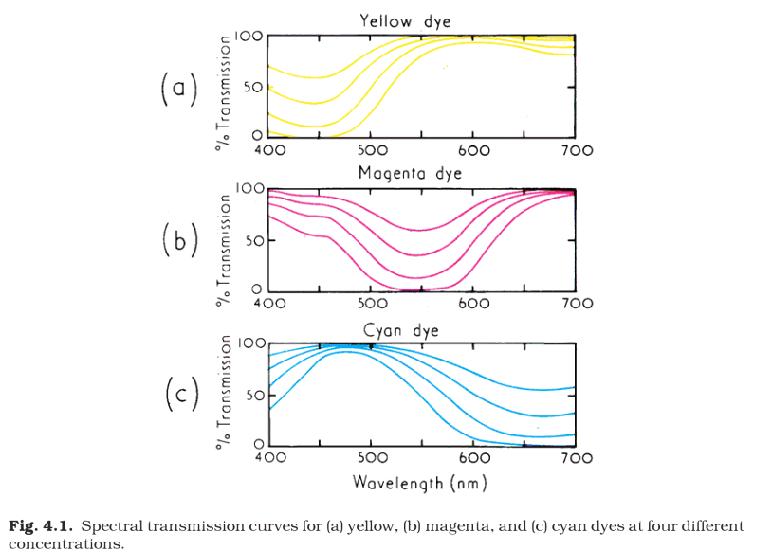

2) The 2nd figure is a graph of the transmissions of CMY "dyes". Which dyes? This figure from the 2000 edition is no different than that from the 1950's edition; is it really the case that no progress has been made in attaining more "perfect" colors?
3) These are the retinal responses induced by the three CMY dyes. Notice how yellow is nearly perfect, magenta less so, and cyan quite lousy.
That is why the green & red separations (magenta & cyan respectively) must be masked to counteract these unwanted responses. In theory, each dye should only stimulate one of our cones.
Thinking this through aloud.... cyan should theoretically only absorb in the red, but it absorbs in the green to a great extent. In effect there is magenta intermixed with the cyan dye. Therefore a weak positive from the green filter separation is added in register to the red filter negative, subtracting the green densities from this layer.
Again, the magenta dye has unwanted absorption in the red (and to a lesser extent the blue) whereas it should only absorb green. The effect is having cyan intermixed (and yellow too). A positive is made from the red filter separation and registered with the green filter negative (and a lesser mask from the blue sep).

As Bob says in his book, these curves for the eye were obtained indirectly, but they are a fair representation. As for your second figure, these are drawn "upside down" from general practice their being transmission curves instead of density.

Thanks Ron, I do recall that discussion about different eye responses. That was in the back of my head while writing this.
More specifically, my thinking is that the sensitivity curves must be the average of many people, right? But what if we tested a million people and instead of averaging the whole population into one curve, we find several groups that show a statistical significance to one another in the way that they skew from the mean. Does that make any sense?
So we have X number of groups, and the members within a group see things similarly, but different from the other groups. There will of course be the median population, but maybe there are groups of outliers that have never seen a print really pop for them.

Actually, the human response can be derived from extracting the dye "sensitizers" from the eyes of cadavers. That is, if you insist on knowing how it is done. Then the researcher can also compare this to light reflected from a living eye by shining light into the eye in narrow beams and recording what comes back. So, there are two sources to derive families of sensitivity.
What we find is that many like one color over another based on the family of dyes in the eye. This is a very rough statement as color is subjective as well. In the end, we have to average.
