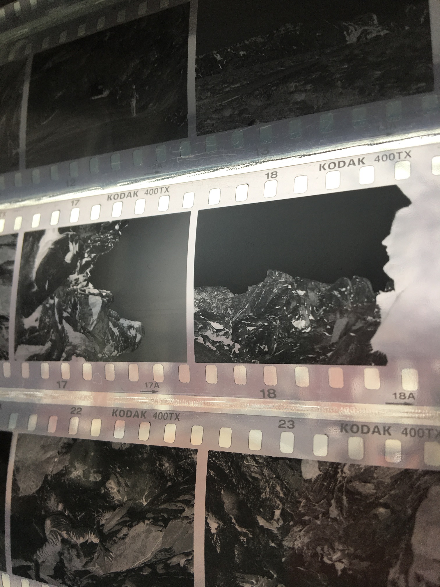

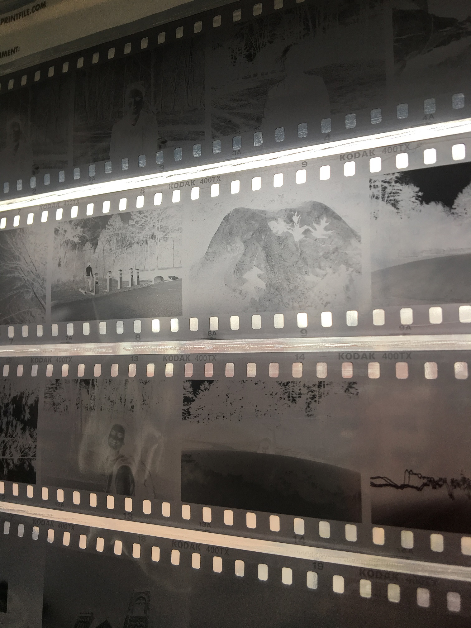

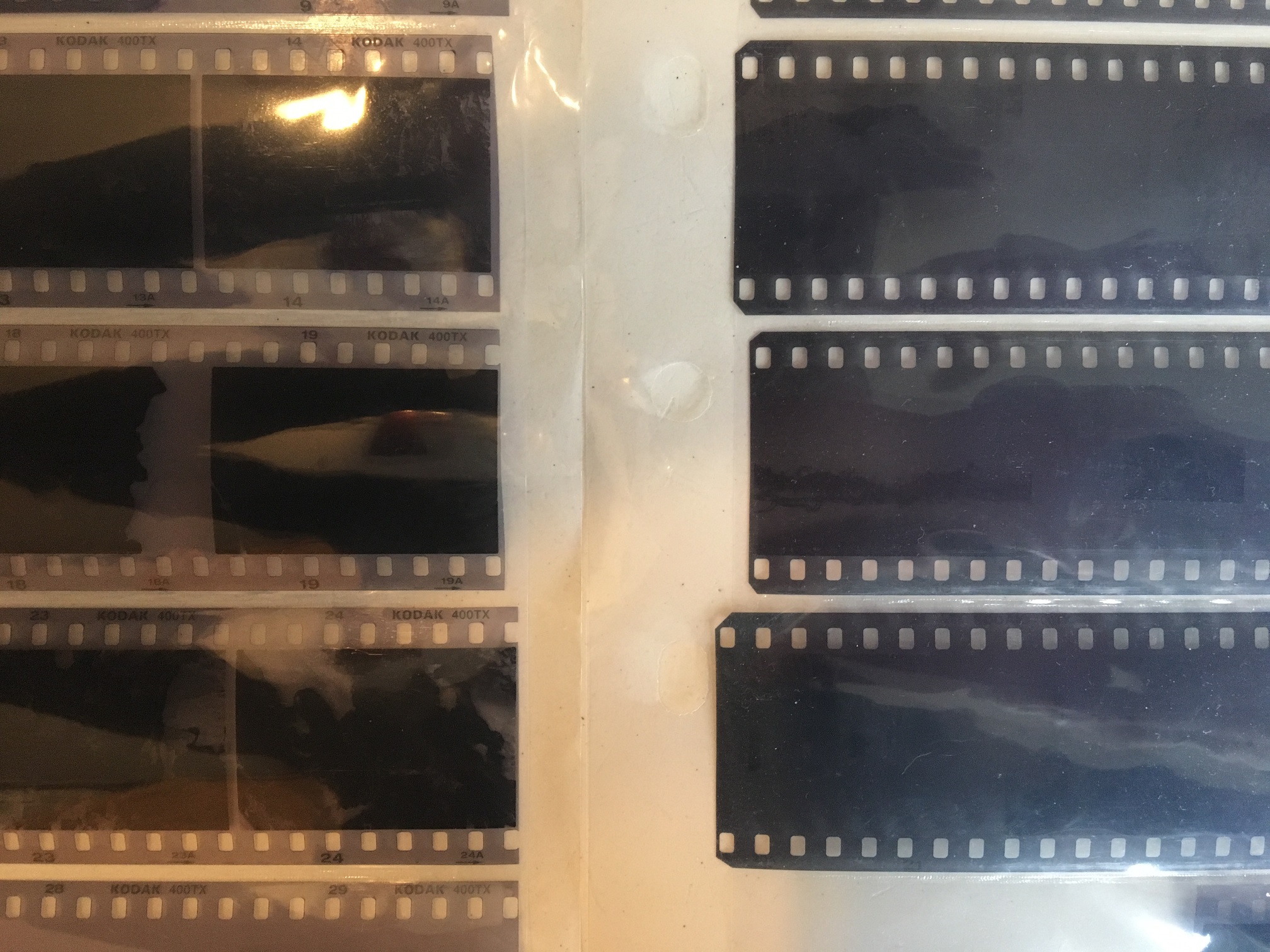

Finally getting around to posting the pictures. Here they are!
MattKing
Apr 24, 2005
52,836
Delta, BC Canada
Incomplete fixing?
