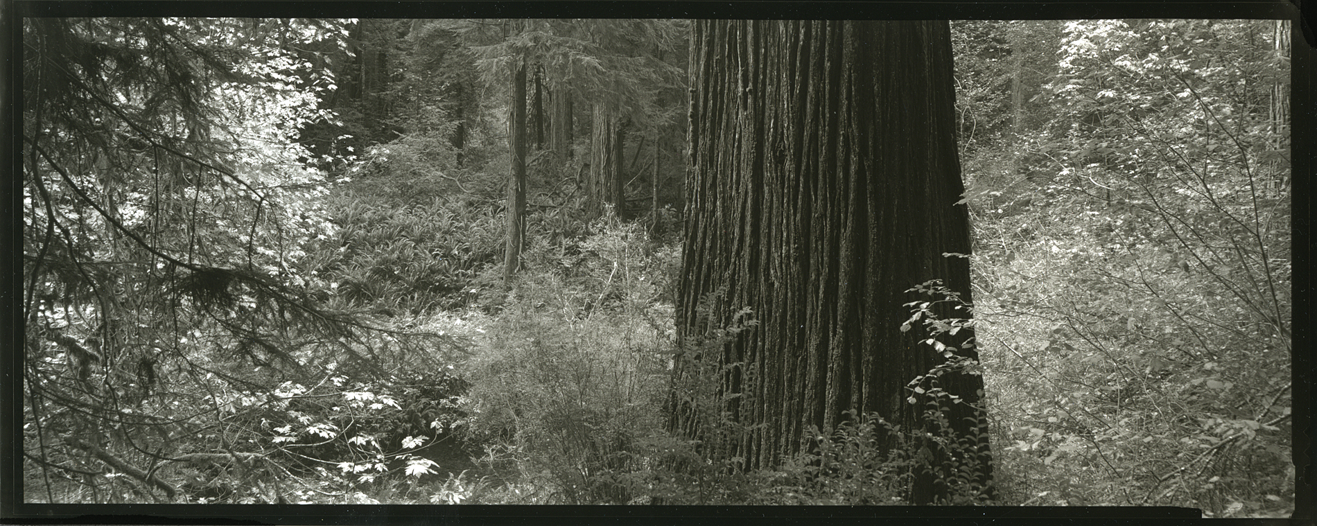

Working in the forest on overcast days can present quite a bit of controlable contrast...
But the best time I found to work was 10am to 2pm...give or take. The overcast creates a giant softbox.
4x10 Carbon Print
Prairie Creek redwoods State Park

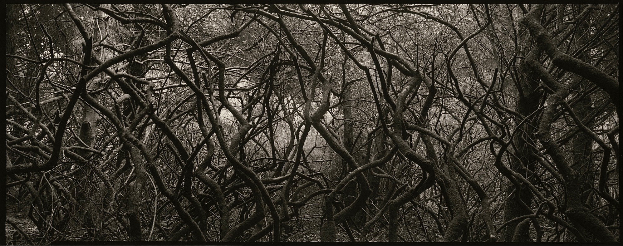

Overcast + tree cover ==> make sure you bring a tripod.
This was an hour exposure -- bring a good book or a pillow -- I took a nap.
Branches, Trinidad State Beach
4x10 carbon print
4x10 carbon print
Wow! That's amazing!
