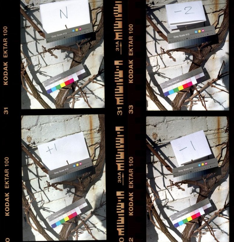

I'd push it personally. Even with standard exposure in borderline conditions (especially in sun) Ektar can take some underexposure, under exposed makes slightly grainy and higher in contrast.
When the film first came out I made a series of tests and was really impressed by the latitude for a higher contrast emulsion.
Try a two stop push, with careful exposure you will be amazed.

Looks pretty good to me Mark for a two stop push
pentaxuser
Actually that was no push just relying on the latitude of the film. Pushing it just mildly say another 30 seconds in the developer would probably result in better results. also if you want more 'pop' and contrast pushing a film such as Portra 160 a stop could give a nice result.

What I should have said Mark is that it was pretty good for the 2 stop underexposure alteration you had to make from the box speed. In fact of the four scans I thought the 2 stop alteration gave the most "pop"
I couldn't see any signs of colour crossover or anything else that indicates that a 2 stop underexposure results in a very poor negative
pentaxuser
My own thoughts on Ektar is that overexposure flattens it or lowers contrast slightly, I have found underexposure gives pop and adds contrast without too much overall cast creeping in-a little shadow loss possibly.
Some people say under exposure is no good and Ektar doesn't have much latitude but I've found the opposite, metering for the shadow and stopping down two stops gives me great tonality and plenty of shadow detail.
Of course light conditions play a bigger part, in bright conditions it can sing and almost give tranny like results:
It's the way it emphasises reds though that I like, similar to KR64 in the way it makes red stand out.

@Mark: Very, very impressive! That was with standard processing, no push? How is it the edge marking shows up in the first shot, like it was Ektachrome or made into a slide? Scanner?
If Ektar is this versatile, I might have to rethink my color film decisions!
