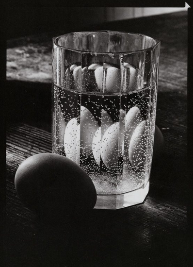

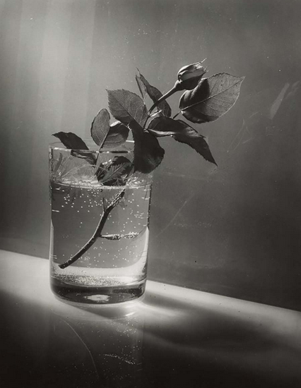

Thank you for your replies, much appreciated, i can take a lot from this info. In terms of how close, i imagine ill be looking at something around this distance (photos attached).
Any more comments are very welcome

i have just attached 2 images so you can have an idea

For 8x10", 1:1 (1X) = 8x10". The subject is the same size as the film.
A subject about 4x5" -- like the two pictures above -- is about 2:1 or a 2X magnification. As koraks also mentioned, a 150-250mm lens will work fine for you, and there are many process/macro/close-up lenses in that range to choose from.

I'd call the scale of any example posted so far as representative of "tabletop" photography, not really "close-up" work at all. If you want to fill the frame with a caterpillar on one of the leaves, that's a different story. Most general purpose studio lenses would do just fine, although I'd personally select a close-range corrected version like a Fuji A or Schneider G-Claron of appropriate focal length.

And Koraks - I do mean close-ups, not moderate distance tabletop shots like the ones posted. But I don't know what kind of 8x10 the original poster has in mind. For studio work, monorail cameras like Sinar make a lot of sense because the length of rail and bellows sections can be so easily reconfigured to anything necessary.
A glass of the kind in the first image is around twice life size if you want it to fill the 8x10 frame the way it does in the posted example (which is evidently not shot in 8x10 of course).
They're still a b*tch to work with with that much bellows draw. Very inconvenient. But yeah, it's possible. At around life size on a 300mm things start to get cumbersome IMO. The glass shot in the first example made with a 300mm lens would be annoying enough to set up for me to stop bothering about halfway through the exercise and just get it over with on 4x5 or so.
