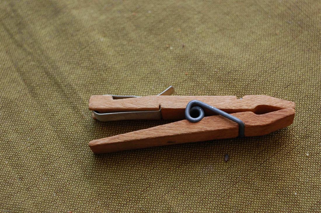

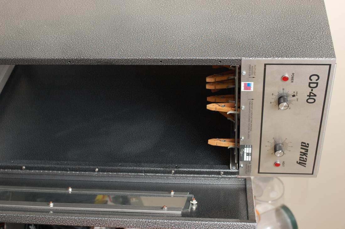

Some super modified Clothes Pins I came across.....
