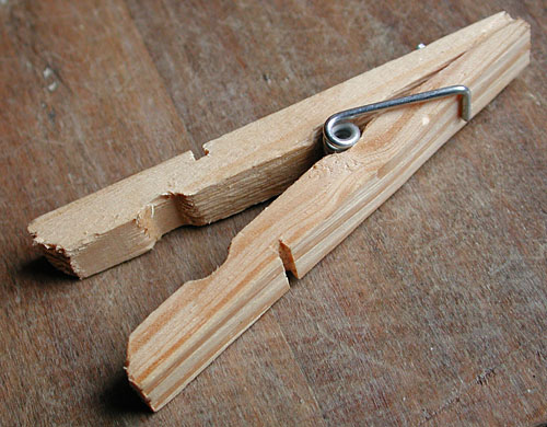

Ansel Adams trick: Take the two sides of the clothespin out of the spring and put them back in reversed, so what was the handle end becomes the pincer end. This will reduce the contact area.

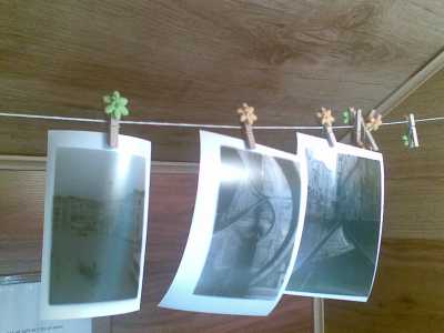

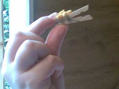

At the risk of outing myself as a "real girl".. I use Dead Link Removed.. They're really cheap, they're tiny, you can get them made of plastic so they will last for ages and they are very easy to source. And they grip just the tiniest edge of film and photos..
Here's mine in action.. they're wooden with little coloured flowers on them..thanks to my daughter for the hand modelling!

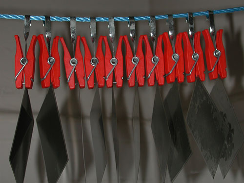

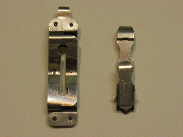

For those who wonder about the attraction of my absurdly expensive Jobo sheet film clips, here's a picture. They make it possible to hang lots of film of any sheet format in little space, because the film hangs perpendicular to the drying line, they have pinprick contact area, and because the needle pierces the film, they can hold any format securely. On occasions where I've had a lot of film to process (these sheets are 2.25x3.25, but my largest are 11x14" and 7x17"), they've been worth the expense. I've got 40 of these clips (some purchased new when they weren't quite so expensive, some purchased second hand), and even when I am using all of them, I have room to hang more film with clothespins.
