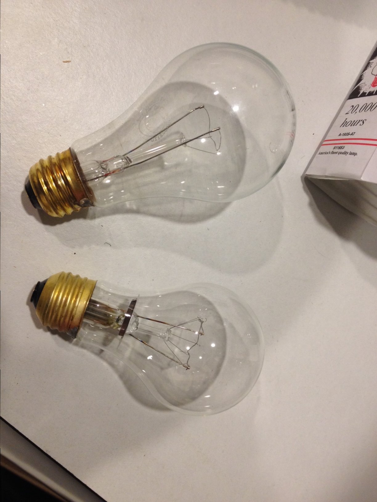

Thanks, Tom. I ordered one of the bulbs with the writing at the top and I'll compare the two. I'll post a quickie photo of the two side-by-side on this thread.
The larger bulb is the original 211-C that came with the enlarger.
The smaller one is the one I ordered. It's an aero-tech 75w with a tungsten element. It had a stamp on the top of the dome, which came off very easily with steel wool. I haven't tested the two bulbs against eachother yet but will post results when I do.

Acetone will remove the stamp. If you do not remove it, it will be on every print.
Order from B&H. Length is fairly critical for even illumination
