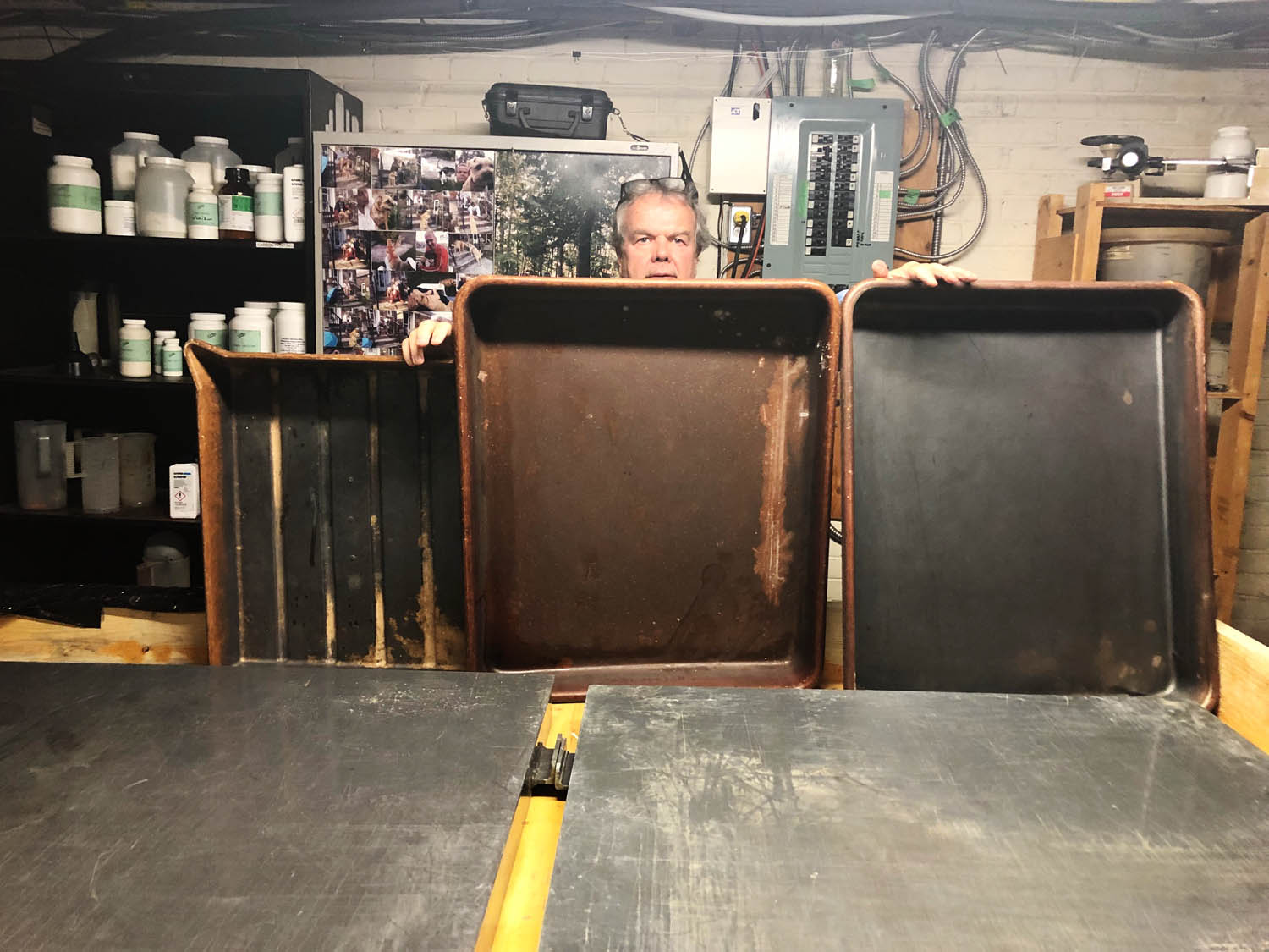

I remember rather clean trays in your darkroom Bob :D

Bob Tray.jpg Well they are clean but not white any more.
