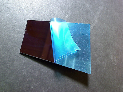

I would suggest a new mirror. You can find them very inexpensively on eBay, and that will improve things measurably. A better focus screen could be swapped into the camera if the mirror doesn't help enough.
