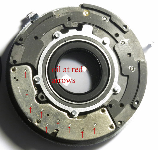

Your other link with 16 pictures will not allow copying so I cannot show you the 9 shaft ends that need the pinpoint drop of oil on the bottom side of the delay(-self timer?) gear train but they are visible in photo 10.
P.S. Being you are not familiar with shutters and their delay gearing, flush it only, do not disassemble the delay gearing unless you can find a service manual for the shutter.
Good morning, and thank you! You can probably right click on the thumbnail and "Save link as" or "Open in new tab" or something similar, but here it is directly.

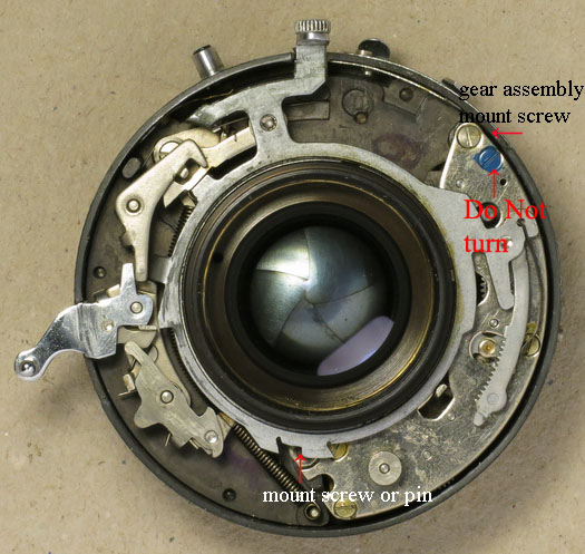

Once again, I have only seen your pictures of this make of shutter. I did not know they existed before your post. From the responses very few readers if any others have.
In your original photos, #6 shows 5 screws, 2 on each end, and 1 outside edge center of the gear assembly. I cannot tell if they hold the top and bottom plates together or if they hold them to the shutter case as well as together. Remove the cocking ring assembly. The outermost screw at the right holds the assembly to the case. The left inner is either a screw or guide pin. If two screws remove both and lift out, if a screw and pin remove the screw and lift out.

To answer SalvSlog's question, yes, the escapement gear-train can come out as a unit. Shutterfinger's photo tells the story - if you remove the two screws he's identified with arrows (and no others) the unit comes out and can be cleaned easily. This shutter is fairly easy to work on, even with my clumsy fingers. Unlike some others, the hold-down screws do not allow you to adjust the position of the escapement unit relative to the shutter body, so if the speed of the escapement runout needs to be adjusted, I don't believe there's any choice but to tweak (very slightly bend) the position of the tab that actuates the brake - that's the tab at 4:30 in Shutterfinger's photo.
