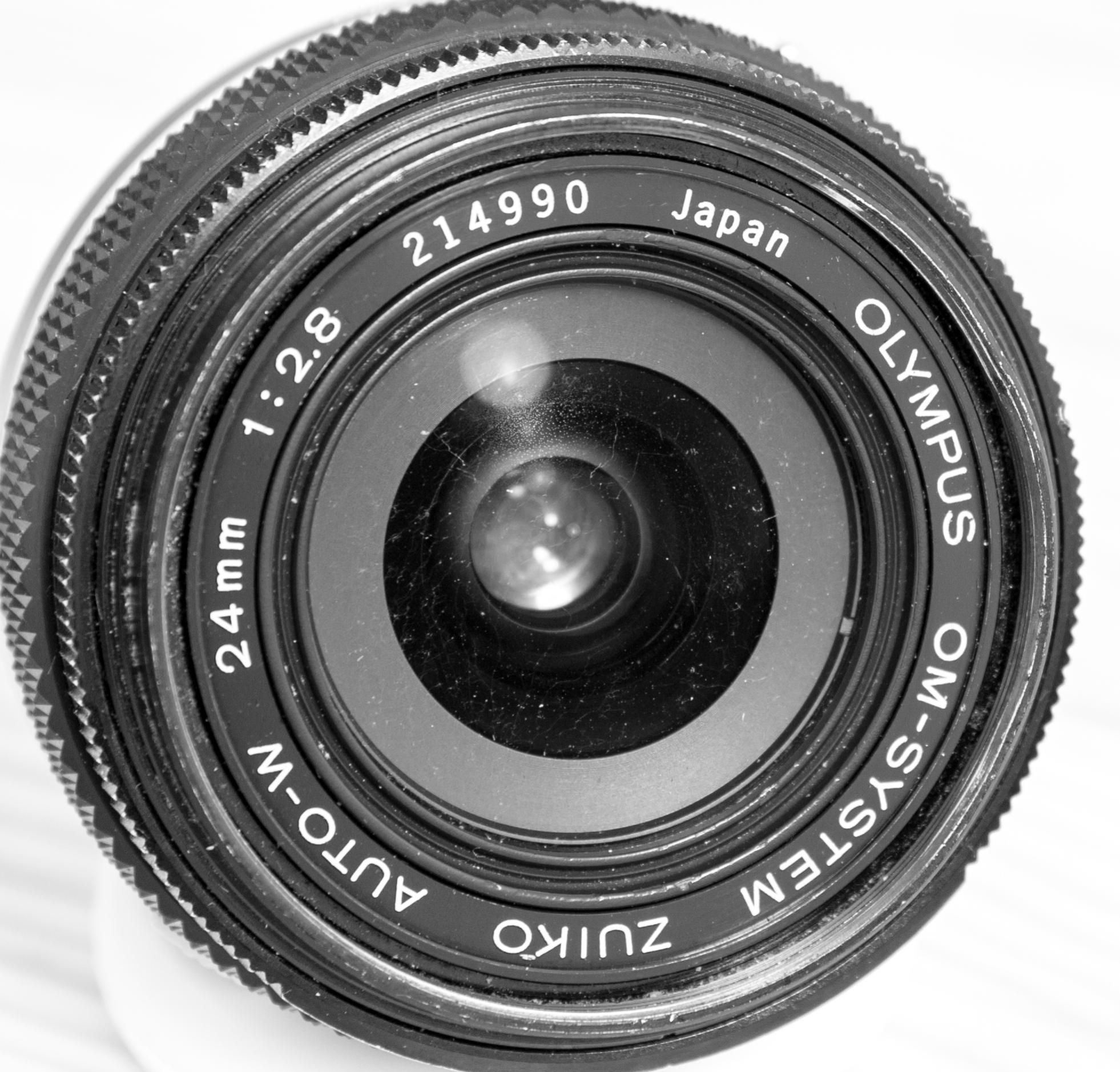

condition of the lens.
Rol_Lei Nut
Jul 2, 2006
1,108
Hamburg
"Hello fungus my old friend..."
or
OUCH! :sad:
It's pretty widespread.
Is there more deeper inside (in the photo the inside looks a bit murky)?
It may or may not clean up well: it depends on whether the fungus has etched the lens or the coating. Hard to tell without trying...

Its just on the surface, I believe. May be I take it to India and put it under scorching Sun for entire summer.
