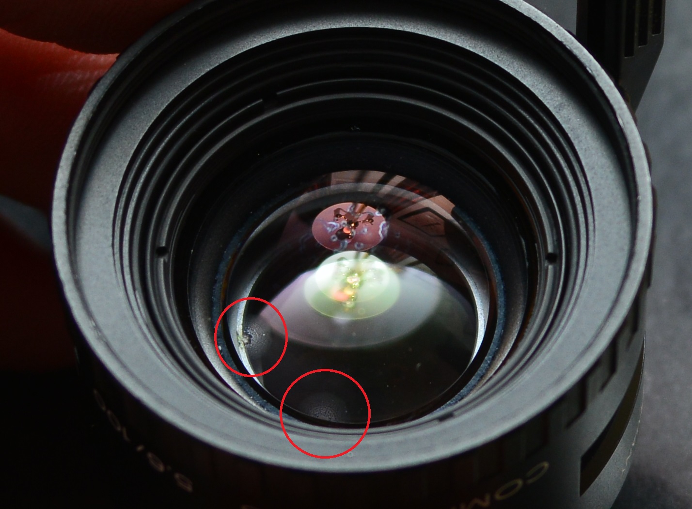

I just cleaned up my enlarger lenses last evening and noticed that my Schneider 100/5.6 has two very small spots with some haze around them on an inside element. It is right along the outer edges of the element, not in the middle. I'm assuming it's the start of fungus. I'd like to get it cleaned but fear I may mess something up as I've never take an optic apart before. I contacted KEH in Geogia and they can do the work but quoted me $130. The lens isn't even worth that much. My question is, can I do this myself? What equipment and cleaner would I need to open this lens up and clean that stuff off?
Or do you know any place that could do it cheaper?

Guys, here's a pic of the problem. There are two areas. the circled area on the left shows it very well. The other one on the right looks the same, with a spot in the middle and a circle of haze around it.
Michael, the lens is the modern Schneider 100/5.6. I've had it close to 10 years. My problem (which I know now) was storing it in the darkroom. I won't do that again.

If that were my lens, I'dl clean it myself. If I mess it up, there's plenty available. To me, they look like fungus. Besides, I don't want to see them living in my lens.
All the 4 and 6 element I've worked on, once I take the front off, it's really easy to get to each element. Some lens group come out as an assembly.
Yes, mine is older, but from the hint bit of a picture you provided, I believe the outer spanner notches will pull the front group. That picture sure isn't much to go on for offering disassembly advice, but if it is like my older one, you can pretty much just grab the rear cell and unscrew it; a gripper would help. Just out of curiosity I looked earlier today to see what I have. I found an earlier version of that lens, pulled the rear cell, cleaned both surfaces facing the diaphragm (working through the aperture for the front). Total time was 3 minutes from when I headed down in the basement to look, until I got back upstairs. I did stop to brush the cat before coming back up (she insisted).
It will take you longer than that, and I would normally take more time, but it really isn't that big a deal. Budget an hour and take your time. If you pull the front you do need to be more careful since you'll have the aperture mechanism exposed, and probably the little ball for the aperture detents. Just take your time and put things back the way they came out. It is almost certain you'll see some dust in there, this design seems to magnify it; I try to blow as much out as possible, but it isn't a problem.
I also can't tell from your picture where the stuff is, so you made need to pull one or both of the groups apart, but that is pretty simple to.
