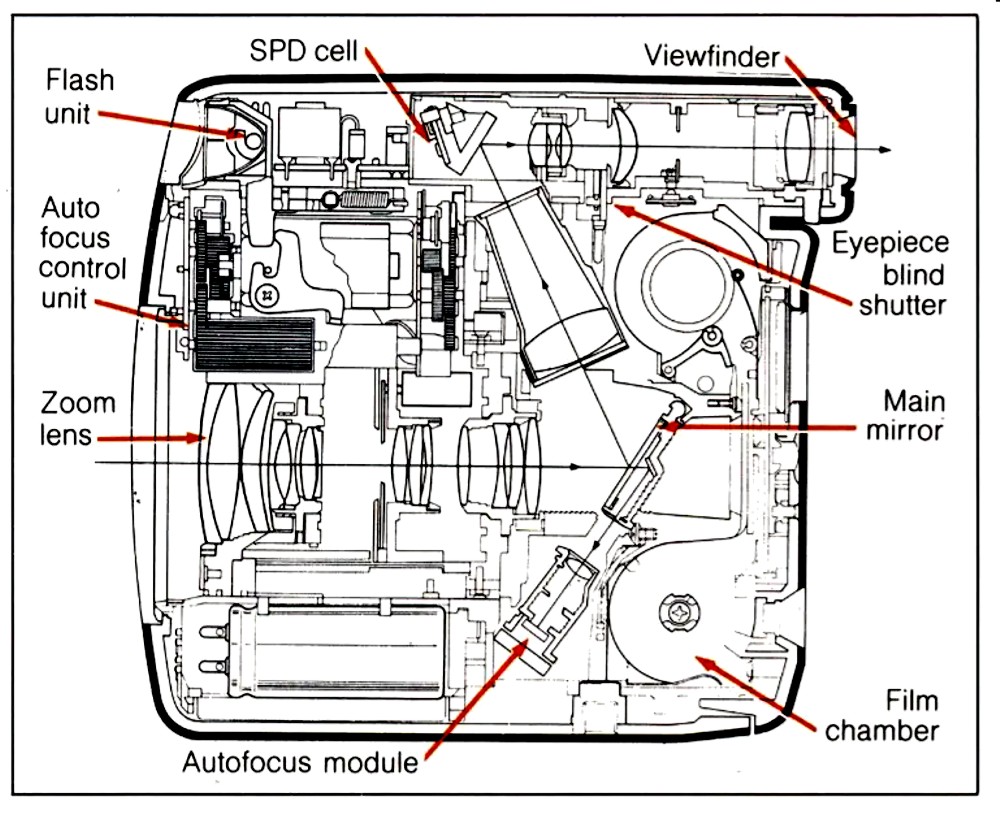

Unless you state which group of lenses are in need of a clean , no one can answer that .
You can see by the above diagram how it's assembled.
The front group might be serviceable without total disassembly, the middle group , not so likely .
The rear group , how would you remove them from the front if they are bigger than the hoke in the middle ?
As it's a zoom lens , it's more complex than just unscrewing one lens .
That's my question do I have to crack the plastic to clean the lens or is it just screw ?
You can take the Samurais apart be removing the screws, but you need to be careful because there are lots of screws -- some hard to find -- and they are different lengths. PLUS, there are several small, plastic TABS that are hidden under the plastic covers. These are easy to break when you take things apart, and then the parts won't fully re-attach.
