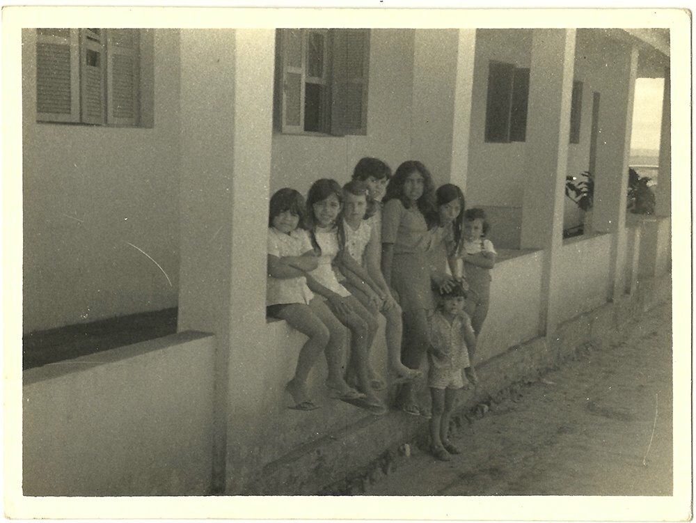

I've been wondering how these white borders on classical pictures where achieved.
I don't know if they came along with the film the photographer choose or if they came after, in printing. Are these possible to achieve today? How to make them?

Both examples are commercial prints, and for a very long time these prints, and most others were made with borders. Matted prints were not made with borders. The printing easel covered the borders leaving them unexposed - white.
The black lines appear to be scanning artifacts.

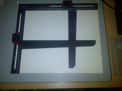

Traditionally in optically printed prints the border was created by covering the edge of the print (with a printing mask/easel). This photo from http://twelvesmallsquares.blogspot.ie is an example of what a darkroom photo easel look like.

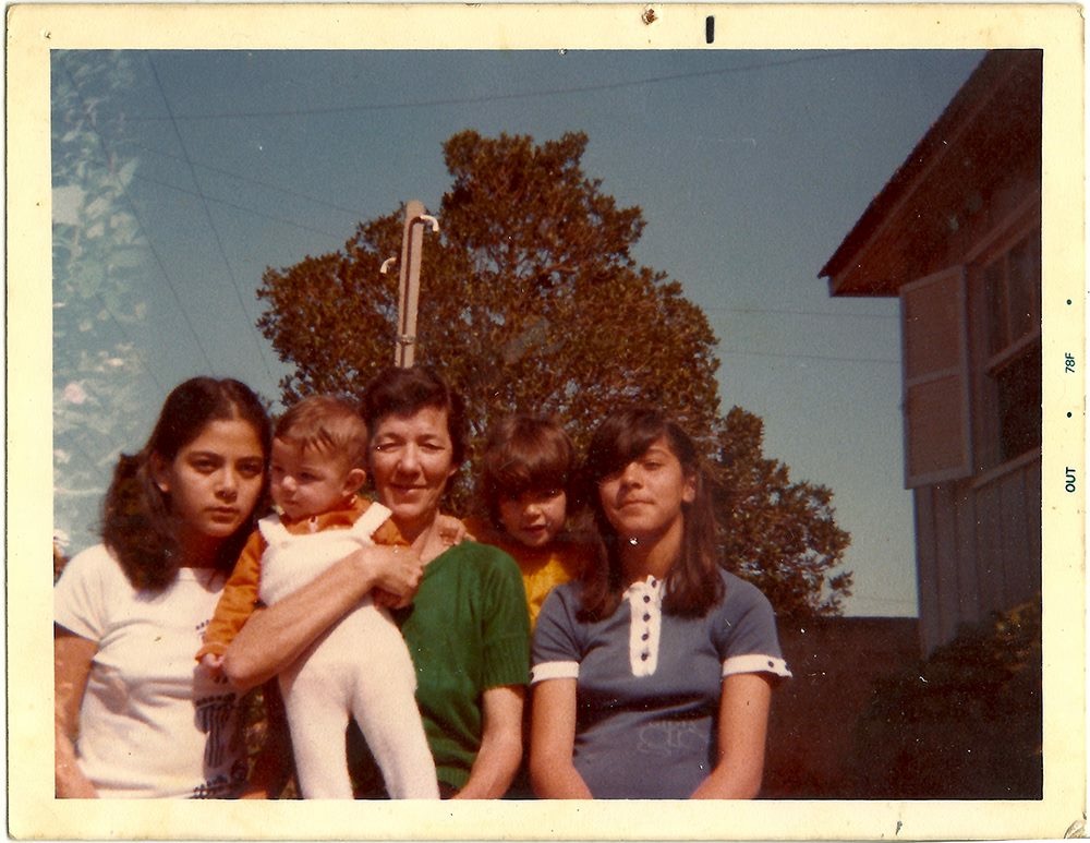

In the colour print shown by the OP, the black line, off centre at the top of the print, is a mark to let the auto print cutter know where to cut the prints off a large roll. (in a wholesale commercial lab, prints were printed in large rolls of paper).

Paper goes into frame (called easel) picture is "printed" within frame, edges inside frame stays white.

On the color photo you can see a black mark in the top border. That is an index mark that Kodak and others used to index the print for an automatic cutter. The prints were made in long rolls 3 1/2" wide for snap shots. After drying, a cutting machine would cut the prints perfectly using the black mark to trigger the cutter.
