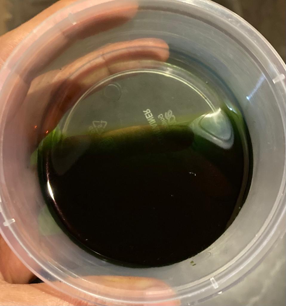

My Solutions A and B look alright on their own (25g FAC and 10g Pot Ferrocyanide each in 100cc distilled water). However when I mix them to make sensitizer a strange reaction seems to take place which makes the whole thing turn a bright deep green and leaves a fine powdery residue which is impossible to filter (image 1).

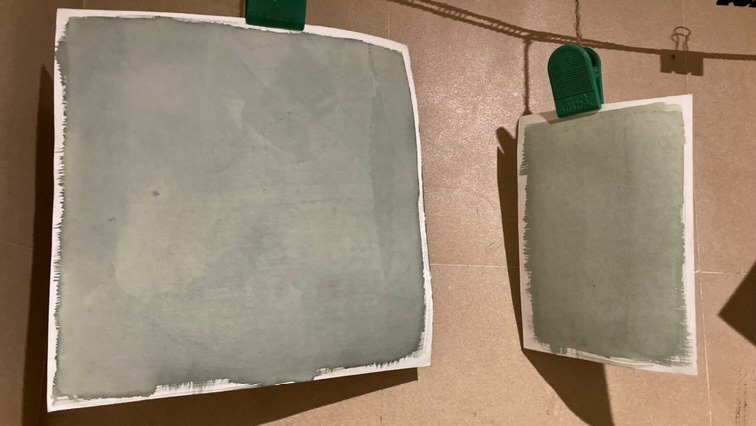

When I coat the paper with this solution the powder gets lathered on with the bright green solution and dries much greener (image 2) as compared to the usual chartreuse yellow I am used to getting.

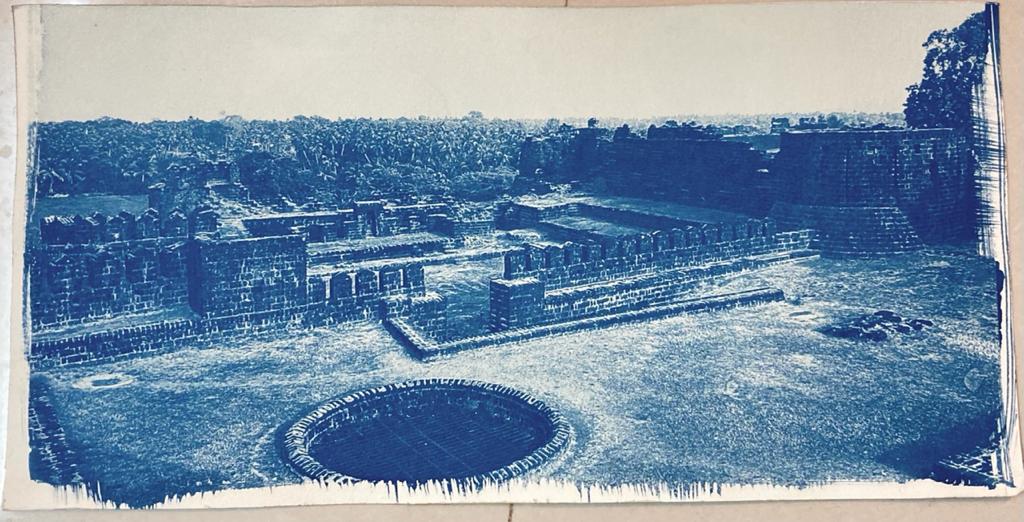

The image I get from this has significantly blue highlights, although the shadows are a nice saturated blue (image 3). I previously had clear whites for the same exposure from this very negative.

Your mixture's color shows that prussian blue pigment is formed upon mixing. Most likely, FAC solution contains ferrous ions. It might be a result of storage conditions of powder, it might be light exposure or it might be heat. I assume you keep your solutions in amber bottles and away from strong light sources.
To remedy this problem you can add hydrogen peroxide to you FAC solution and ferrous iron will be oxidized to ferric iron. In order to prevent diluting your solution use high concentration of peroxide. A few drops of 30 or 50 percent hydrogen peroxide added in to your FAC solution could fix it. After adding one or two drops of peroxide, throughly mix your solution then on a white plate/dish mix one drop of newly mixed FAC with a drop of PFC. If you see no color change, then the problem is fixed.

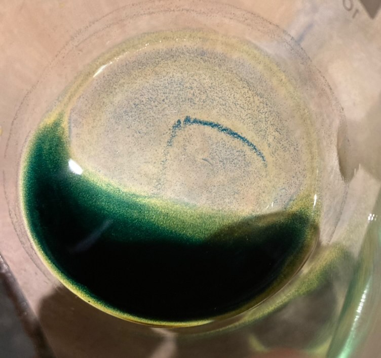

I tested this out and it seems 0.1ml of 5-7% w/v peroxide in 10ml of FAC does the trick of not having any powdery residue. However, the colour of the sensitizer is still a little too blue-green and I maybe see some clouds of Prussian blue instead of the powder.

Coated with this anyway and exposed it. The blue was not as rich but the whites were clear! But I must test this once more because it was pouring today so the exposure might not have been sufficient for the blue to develop. 90 footcandles only for 4 hours. The test of developing "unexposed" paper in water was successful in clearing it of all blue.
