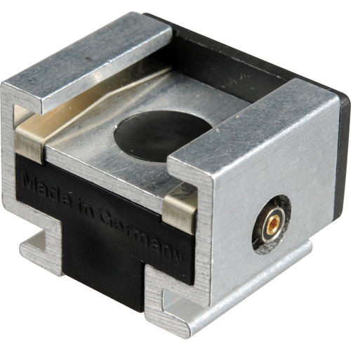

wiltw, what I linked to on the B+H site is a hot shoe that connects via PC to the camera, and then you have a hot shoe on a camera that only has a cold shoe (or no shoe at all).

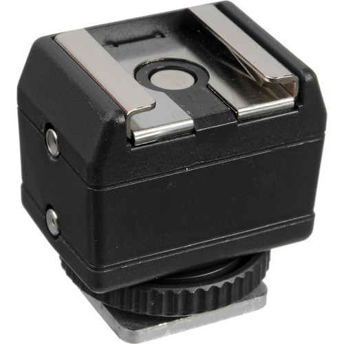

There is also this one, which does not have a built-in PC cord (you supply your own) - https://www.bhphotovideo.com/c/product/89979-REG/Hama_HA_6951_Hot_Shoe_Adapter_1.html
I also have this one, but I hardly use it - https://www.bhphotovideo.com/c/product/89977-REG/Hama_HA_6950_Universal_Flash_Adapter.html
HAMA makes a bunch of different hot/cold shoe PC things that allow for use of triggers and modern flash units on non-hot shoe cameras. Just put "hama" into the B+H search box, and you'll find tons.

Ordered the hot shoe adapter. I'll update when I get it in.
Well, got the hot shoe adapter. Mixed results so far.
I can trigger the speed lights (YN600 EX-RT) but it won't trigger the YN-E3-RT.
Putting the speed light on the adapter it works but also won't trigger a slave in radio mode.
They will work in optical slave. Still need to play with them some more and I hate to admit it but I might have to break out the instructions.
Since all the adapters are just center pin firing, it must be something with the flash/triggers, unless they (the flash/triggers) need more then just the firing signl to work fully, which makes little sense to me.
One problem with metal cold shoes like your yashicamat is that the shoe will ground out the center pin if the adapter is designed for a hot shoe contact, it may be throwing things off.
I use a remote trigger on my 124 with the pc connector but have to tape off the base of the cold shoe to prevent shorts (random flashes)
It's possible the YN-E3-RT requires a TTL body to connect with. The same happens with the YN RF-602 and 603 mkI
