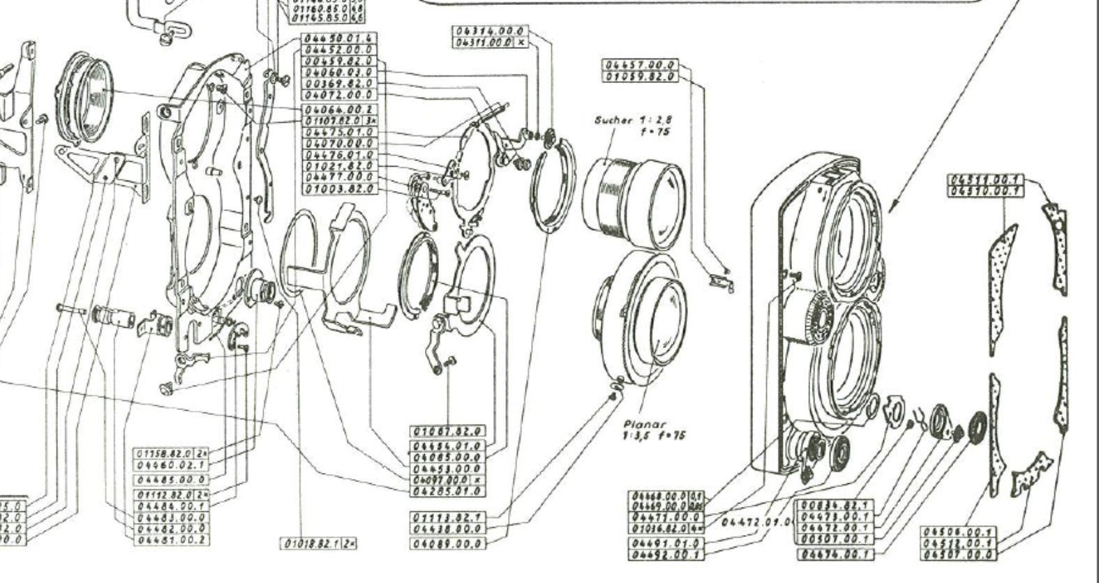

Download the Compur Service Manual at: https://www.scribd.com/doc/44503560/Compur-Shutter-Repair-Manual
The Special Shutter for the 3.5 is CS-1110-230a which is not in this manual, it will only be in a Rolleiflex Repair Manual.
The base shutter is CN-1110-000. Your shutter will have a different shutter release, speed dial and face plate, different flash sync connection, and the aperture lever may be different.
The manual is engineer diagrams which some find hard to follow. There are few special adjustments directions, and the lube diagram only list Rolleiflex numbers for the lubricants.
Download this Rolleiflex Repair Manual from my google drive: https://drive.google.com/file/d/1Kg50l0ttSdnWiXQWsNI1X3P5JfasLbOd/view?usp=sharing its 61.5kb. The 3.5 begins on pdf page 67.

Shutterfinger, thanks for the material. The Compur material is awesome, whish Rolleiflex material could be on that level :smile: I don't know how they had such resources to do the manual. I'm considering making a poster and frame it from one of those blow-ups :smile:
Any ideas how to screw the lense open on Rolleiflex? I've seen a "door stop" rubber used but is there any other way without needing to buy a door stop and modifying it?

According to the Compur manual the Rolleiflex 3.5 came with Xenor, Tessor, or Planar all f3.5.
Thiks is the lens diagram for a Xenotar, a Guass design listed as being used in Rolleiflex Cameras 1954-1955 in f3.5:
Tessar:
Light traveks the direction of the arrow. The tip of the direction arrow is the approximate position of the shutter and aperture blades. The lens cells each side are in a barrel that screws into the shutter. Each barrel has at least one retainer ring that holds one or more indivual or elements or pairs in place.
Use a rubber strap wrench such as https://www.amazon.com/Craftsman-Pi...4?keywords=strap+wrench&qid=1571436134&sr=8-4 to remove the cell barres from the shutter.
Use a spanner such as https://www.ebay.com/itm/DSLR-Camer...783511?hash=item1f0240bdd7:g:KSsAAOSwo25dpnw~ to remove the shutter retaining ring or element retaining rings.
