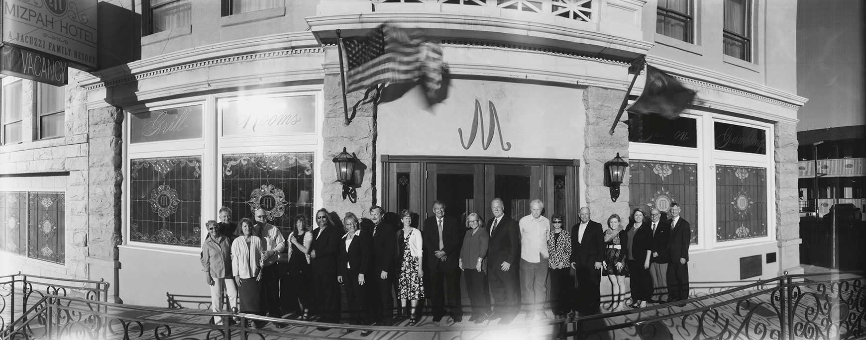

Here's a shot I did with the venerable #10 last March at the high school.
Developing is where I draw the line. I sucked at the bathtub gin route and had an 8' long stainless tray built to get at least even development. You can see I still managed to booger the picture in camera. Hey it's 2014 and no one expects perfect Cirkut pictures anymore. The High School was thrilled and displays this picture proudly. Even the kids were enthused at the ancient technology. The guy on the far left did a 'pizza run' to get in the image twice and almost didn't make it in time. Everyone was smiling watching him do it.
BTW I set up the shot with a piece of rope tied to a spray paint can that painted a line in a perfect arc from the camera.
I scanned this on an Epson V700 and stitched it back together.

Nice picture! The defects kind of add that antique-wet-plate-developed-in-the-back-of-a-horse-drawn-carriage look to it. Heck, you'd probably have to pay $100 for a Photoshop filter to give you that effect...
If I may go briefly off-topic into hybrid-land... is that a print or negative scan with the V700? I also have a V700, but my giant scanner can only do opaque stuff. Currently. My inner MacGyver has pondered how to turn it into a giant transparency scanner. I'll probably get a darkroom set up long before I ever get around to that, though, and then I can just make contact prints which are easier to scan.
Duncan
Duncan
It's a neg scan and the print is digital on an Epson 4800
Sorry to scandalize the purists. :wink:
