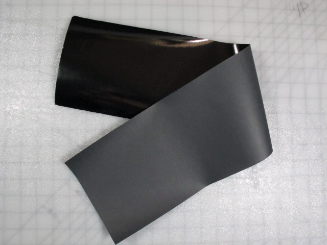

I have Exeter paper rolls that are 26" wide. Opaque on one side and glossy on the other. How long are the leaders and followers for Cirkut Camera film?

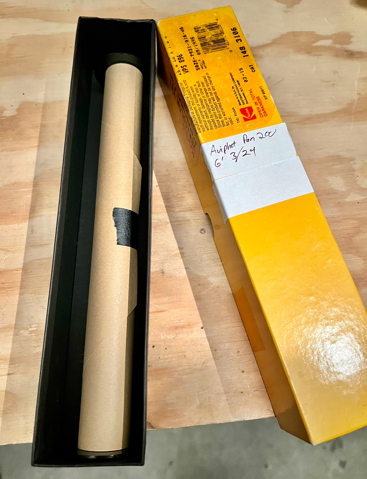

In preparation of cutting my own leaders for 9.5” aerial film recently, I measured the 10” leaders I have at 22” long. Followers were 28.” For my purposes, I just cut a batch of brown craft paper leaders measuring 18,” which is the max my Dahle paper cutter handles. It still gives plenty of wraps around the 3/4” diameter spools. I skipped the followers and just taped the end of the film directly to the spools. I’ll find out this week when I do some developing if they did the trick.
