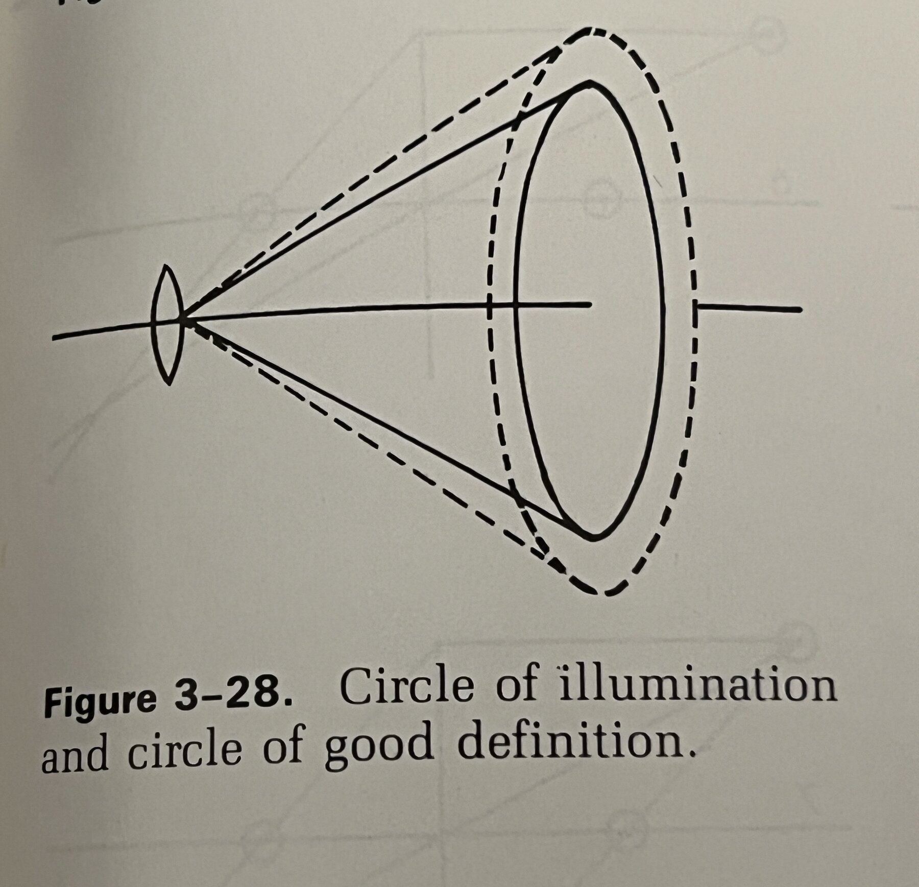

I was aware of the idea of an image circle of lens and how they cover the format of desire. But the Stroebel book “View Camera Technique” 5th edition, has this (new to me) idea of “circle of good definition” which is not the same circle of coverage because it is likely smaller than coverage. Now, that makes sense. But I never considered it before it was mentioned. But what is meant by the second image, “substituting a longer focal length of conventional design”?

I found this definition for 'Image Circle': "An image circle is the circular, light-projected area a lens creates on an image plane (sensor or film). It defines the maximum area of acceptable image quality, usually covering the diagonal of the sensor to prevent dark, vignetted corners. And so it seems that the common 'Image Circle' is Stroebel's 'Circle of Good Definition'

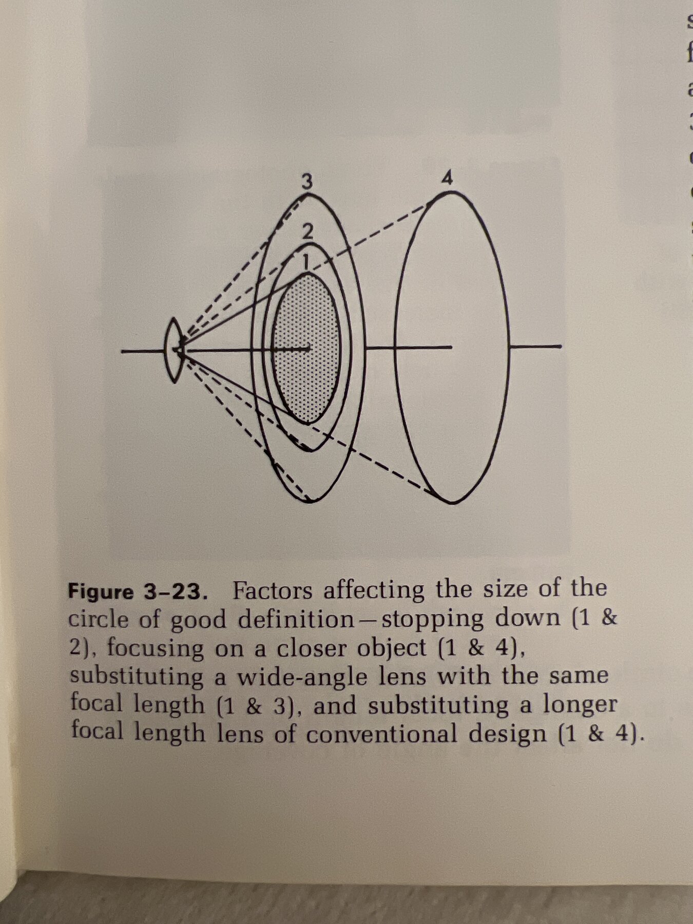

The text for the illustration does give an explanation that by inference you can determine that a conventional lens is neither a wide angle nor a telephoto design. This is from the 3rd edition, so when it says Figure 99 it is the same figure as 3-23 above).
