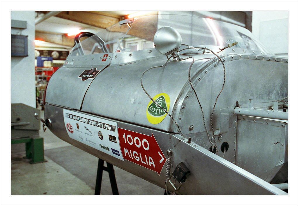

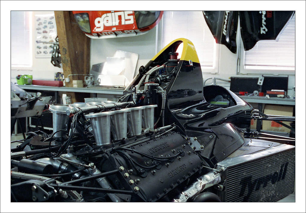

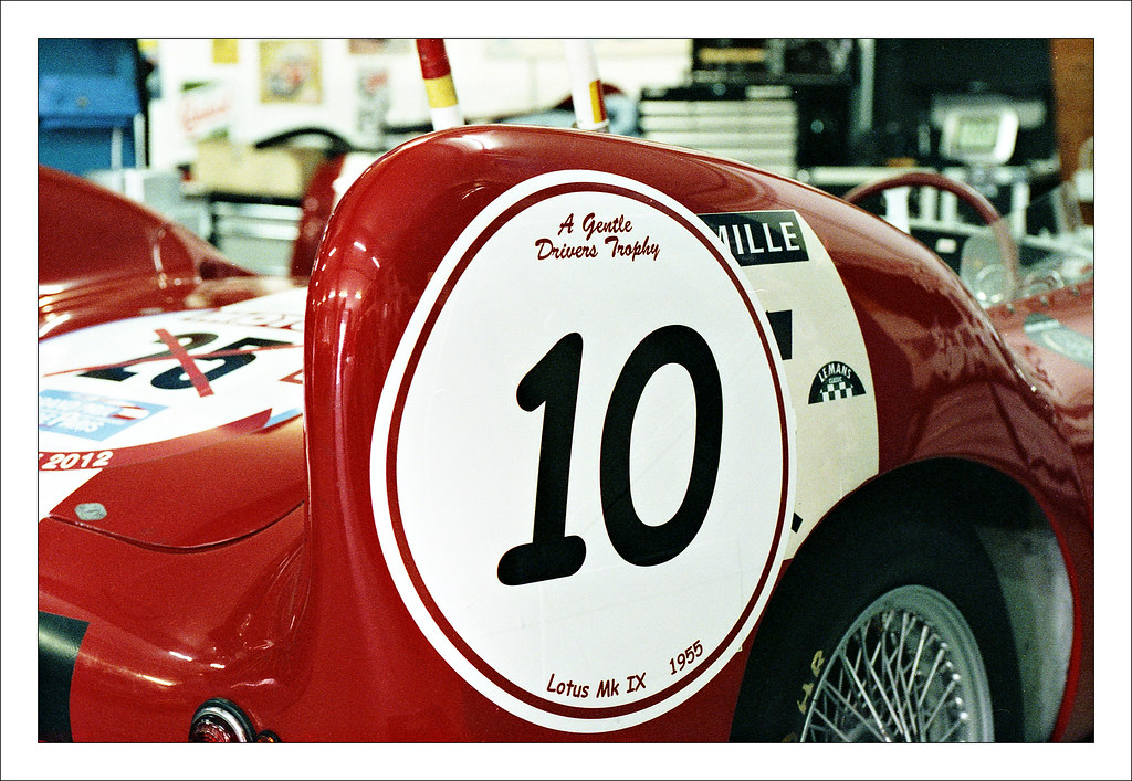

Eric - to come back to your aproach on 4x5 (to feel like 22y again). :
I also shooting Cinestill 800 - I am not from yesterday !
As mentioned before there is no way with 4 x 5 inch (and you will not call Cinestill and ask about
70.000 sheeds I guess?) Remember that Kodak Vision film is made from larger format Masterolls - so theoretically 4 x 5 sheeds are possible !
But I guess Eric - therefore you would have a need of a greater order = > 70.000 sheeds..:sad:!
What about :
to come exactly to the look of Cinestill isn't possible (you allways need the original - imitations are never 100%)!
1) to imitate the lack of antihalation (you don't need this layer with Portra400 this film has its own
strategy to avoid halation of light!
how would it be with push 1?
Your contrast would come up that COULD imitate the glowing reds of Cinestill in parts! Look :
That are the glowing Reds (typical look from Cinnestill 800 here it is more white from massive overexposured highlights)!
So a push1 would also compensate your correction filters - but I would not push as high
to come to real ISO 800! (beside the fact that youngest shooters are often world master champions
from pushing films) we have not to prove Eric - or have we the need to do:sick:.....Damned I am also
not any longer 22yo...:sad: - but would I feel just a bit younger with push3???

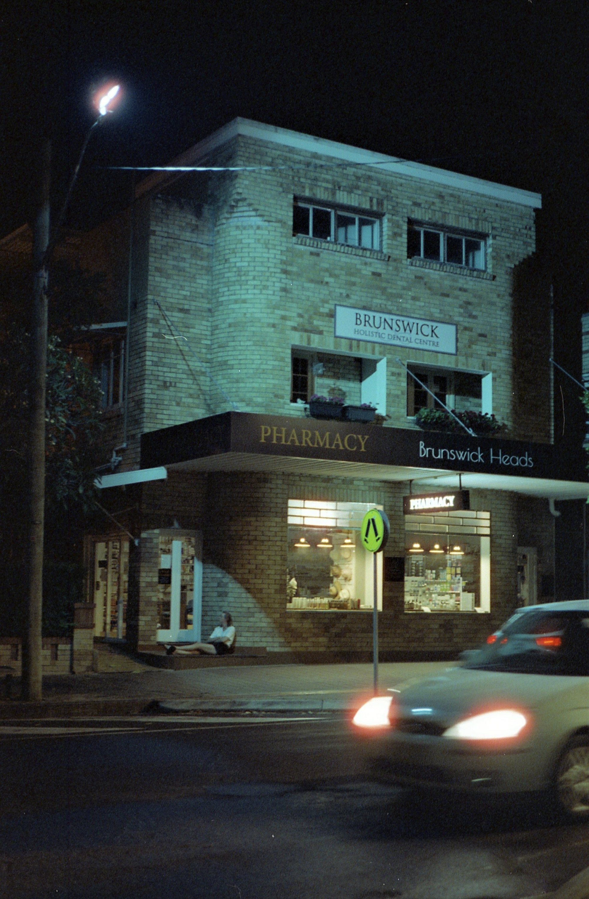

Not so bad for a beginner with a $15 camera and a $90 lens:smile:. Probably get better colour saturation if I new how to use photoshop. I have another roll in the fridge I might try again sometime soon.
Hmm regarding your "Brunswick" house thats the issue of c41 to ECN 2 film!
It is looking "not soo bad" again but to me (or is it from scanning and post production) these kind of colors I can't remember from Vision Films!
It is too much Celvin transformation than the ECN2 original "Thungsten" will serve!
BTW : I have less problems from Celvin 3200 lights with daylight films (for night shots exclusive)
NOT IN GENERAL of course! You then have a "artificial light athmospehere" wich let you feel
NORMAL! Here is one example (no it is not Vision film AND it is post production made )
but from a general example :
That is "Thungsten light" mixed with "Daylight (HMI)" and the yellow light in front is looking "normal"!
Here is a scene from overdriven look - but this is intended : (dramatically lighting)
Now pls. regard your pic. I mentioned again : Your color temperature is most correct
but it looks real " artificiell " - that seams to be what some stated in regard of
Cinestill800 : "The difference in colors - caused from c41 development to Ecn2 Films"
with regards:wink:
PS : But I am not sure about - it could also have a couple of other reasons !

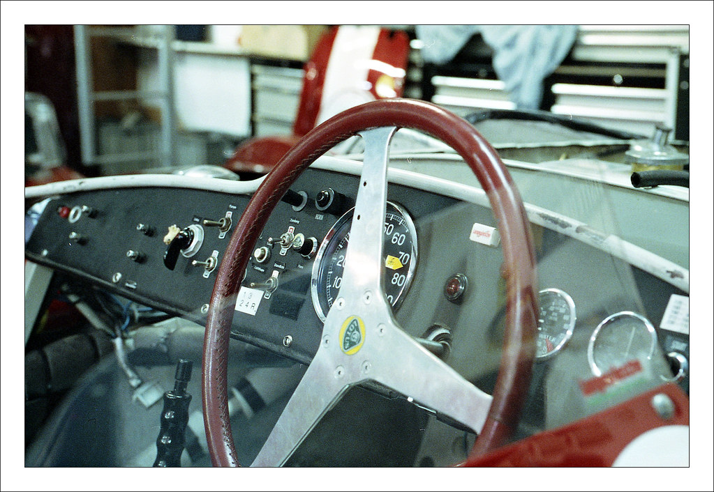

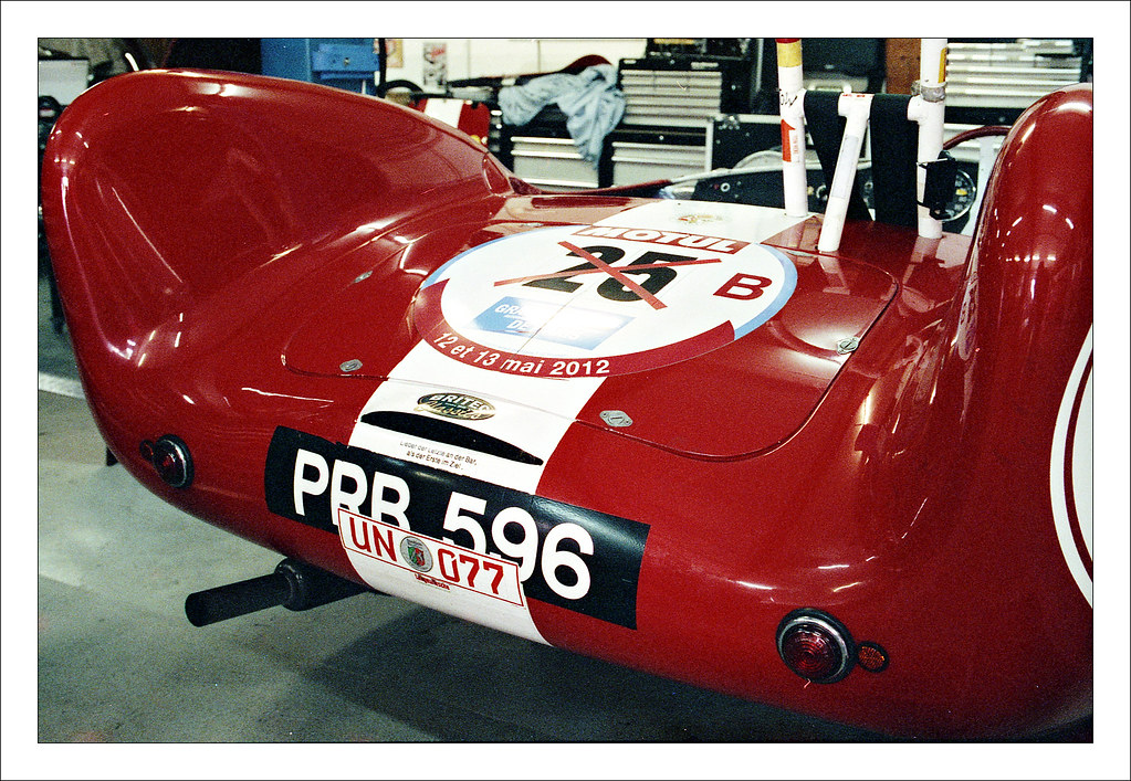

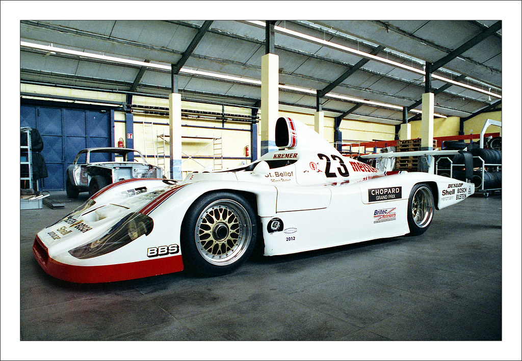

Some of my results in 35mm - Nikon F4 - Nikkor AF 35-70mm f/2.8 and Nikkor 24mm f/2.8 Ai-S
Cinestil 800T @ box speed - captured at Britec Motorsports.
A little warming up with filters could be nice.
